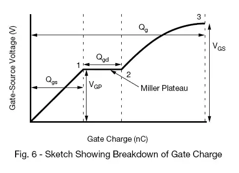

You're missing that the gate charge is specified at Vd = 0.5Vdss = 125V. The charge on Crss must also be supplied through the gate. I suggest reading this Vishay application note:
Power MOSFET Basics: Understanding Gate Charge and Using it to Assess Switching Performance.
The below diagram is taken from there.
In this case:
Qg = 185nC
Qgd = 80nC
Qgs = 50nC
