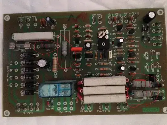

resistor values here is a picture of the power regulator board
could someone please tell me what the value of the three resistors in circle
(R1) 1 orange,orange black,gold red,red,black,gold and the same for the third
(R2/R3)second the grey resistor
(R28) brown,black,silver,gold,black
(R30)not sure if its pink,purple or brown , red,gold ?
the rest i have managed to get the values
i cant seem to find hem anywhere thanks

See this handy table from Digikey:
R30 (39?) 1K 5%
R28 0.01 ohm 5%
R2/R3 22 ohms 5%
