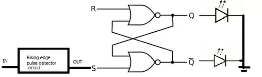

I do not expect the short output to be seen through a LED so, to test it, I make it trigger an SR latch to its up state: SR Latch
However, it doesn't have effect on the latch. So I added an inductor to delay the input to the NOT gates in the pulse detector circuit and it worked: Pulse detector with inductor

  • To where did you tie the 'R' input of the SR latch? – Golaž Apr 19 '15 at 17:44

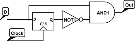

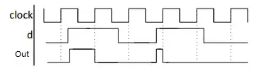

You may implement this digital design for detecting rising edge.
The output will go high as soon as a rising edge is detected on the D input. The output is cleared on the next rising clock edge.

If your schematic is correct, your problem is that you're letting the R input float. With 7400 chips, a floating input functions as a logical 1. As a result, immediately after your set pulse occurs (and it's only about 30 - 50 nsec, so you won't see it visually), the flip-flop is immediately reset.
You need to generate a normally-low reset pulse on the R input before you try to operate your circuit.
WhatRoughBeast
  • 59,978
  • I'm sorry my schematic is somewhat crude I did actually put all the pull-down resistors wherever necessary (clock input and SR latch). – nc404 Apr 19 '15 at 20:12
  • 10k pull-down resistors are not adequate. Use a 1k pullup resistor on an unused inverter or NOR gate, and use the output of the gate as a logic 0. 7400 input current is nominally 1.6 mA, with a 0.8 volt low threshold. 1.6 mA into 10k gives 16 volts. A 10k pulldown is the same as leaving a 7400 input floating. It works (pretty well, but it's a bit high) for CMOS, but not for TTL. – WhatRoughBeast Apr 19 '15 at 20:33
