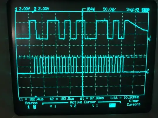

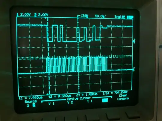

A clean CLK/MISO measurement from the magnetometer

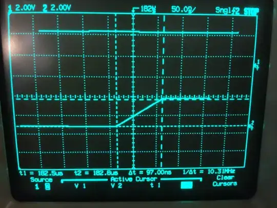

Measuring clock transition time of the CLK signal
Does this MISO line (channel#1) show reflections?  The levels don't look digital with stair case, is this reflections

    I would suggest starting with the SCK line first before adding Rs and Cs to the other lines. After all, edges only matter on the clock line, the other lines will be more tolerant of reflections. – alex.forencich Apr 19 '15 at 08:23
    And with this sort of an issue, it's the edge slew rate that's the problem, not the clock frequency. If you see the same problem independent of clock frequency, then the fast edges are the problem and need to be slowed down. – alex.forencich Apr 19 '15 at 08:25
    Appreciate the help Alex and Efox29. As Alex mentioned, it was the edge slew rate (100-nsec) that was the issue. The issue observed was independent of the SPI clock frequency. I ended up having to put a RC LPF on both the SCLK and MOSI lines to get it to work. I ended up using a 330R/47pF RC filter which has a -3dB of roughly 9.5 MHz. Interesting enough, it only worked when RC LPF was placed on both on both SCLK and MOSI lines. – shraken Apr 23 '15 at 00:40

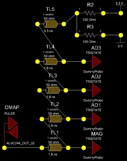

It's difficult to answer this without all the details, but here is a generic look at the problem which I believe may also be the more useful type of answer for this site.
Multi-node-nets should always be simulated. They are so difficult to predict. And it took about 3 minutes to see that your design was maybe not optimal.

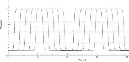

Here is the simulation setup for the clock from the master to all the slave devices (values are just rough estimates, as would be the case if you did this before building anything):
And the resulting simulation plot (we ignore what is what, units etc. as it obviously is not worth building):
The first idea that comes to mind is a daisy chain of all the inputs and a simple parallel termination. A fly-by scheme if you want. This looks like this in the simulation setup:
And the result plot looks a lot nicer:
If you can live with the increased power consumption of the thevenin termination and the reduced voltage swing on the clock inputs of the various devices and... (only you know the actual constraints)... then some variation of this may actually be worth building.
There are other solutions that would work, but the key is to understand that multi-node nets are not easy to predict. The 5 minutes of simulation here before you build something can save a lot of time later. Unfortunately this type of simulators do not come cheap.
I am using Cadence SigXplorer here. The usual disclaimer apply: I do teach classes in signal integrity and often have Cadence or Mentor sponsor software licenses for those classes.

  • What software are you using to sim transmission lines ? – efox29 Apr 19 '15 at 23:56
  • @efox29 Cadence SigXplorer and Mentor Hyperlynx. – Rolf Ostergaard Apr 20 '15 at 05:15
  • @nickishere (OP) Did this answer your question? – Rolf Ostergaard Apr 22 '15 at 14:55
  • Hi Rolf, Thanks for taking the time to simulate this circuit, really appreciate it. I'll have to look into Cadence SigXplorer and will def. look for a tool like it next time I approach this a large bus. I'm marking your answer as correct as it's the most detailed and pertinent. However, I must say I did end up using the topology empirically so I cannot say it works. – shraken Apr 23 '15 at 00:46
