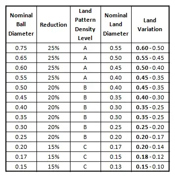

Finally here's a link from mentor describing more than you'd ever want to know about BGA pad size. For instance it shows this IPC table:
With your ball diameter being 0.25mm, that looks like a land pattern of 0.20mm.
