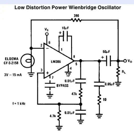

Here is the circuit I've been working from, it's from the National Semiconductor LM386 Low Voltage Audio Power Amplifier datasheet-
wien bridge LM386

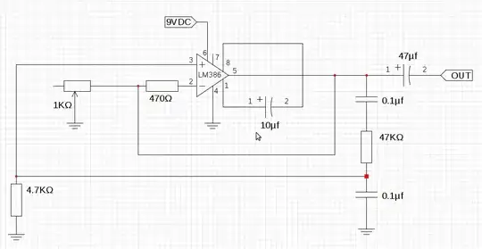

And this is what my implementation looks like, I don't have a suitable incandescent bulb so I've just replaced it with a 1KΩ pot. I'm still not sure what I'll use in the final circuit as AGC, suggestions are welcome.
my wien bridge LM386

The reason for using a small incandescent lamp is that it has a positive temperature coefficient (PTC), which the oscillator needs to stabilize the amplitude. The potmeter won't do.
The negative feedback resistor should be at least twice the resistance of the PTC.
The oscillator frequency is determined by the two resistors and two capacitors on the non-inverting pin, and the schematic seems to have an error: both resistors should be equal (either 4k7 or 47k), as should the capacitors. The frequency is
\$f = \dfrac{1}{2 \pi R C}\$
So you can control the frequency by using a stereo potmeter for the resistors. Both channels should have good tracking.

  • I'm aware of this phenomena, I've got the pot so I can produce a sine at a fixed freq. I intend to use a component with a PTC- just probably not an incandescent lamp. Thanks for the equation and tips, I'll check them out. – Jim Jul 08 '11 at 11:32

Sorry this is so late. The bulb is there to provide amplitude stability to the oscillator to stop the feedback running away. As the current through the bulb increases it get hotter. As the bulb's filament heats up its resistance increases and the feedback decreases. It can quickly stablise the circuit and can be very effective.
