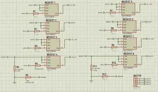

Last year, i designed a stepper motor driver card with DRV8711 and CSD17506. I am driving my stepper motor with Vm=24 Volts and motor current Im= 2.14A. Texas Instruments gate driver drv8711 is driving both high and both sides. The design schematic values are same the as DRV8711EVM user guide. Here are my H-Bridge schematics. enter image description here enter image description here enter image description here
My company is using this card in our products and at least 100 cards worked great and there was no problem until new Mosfets arrived. We get these mosfets from digikey.
The problem is, when I powered 'MOTOR', one of the high side Mosfets burn suddenly, some of them are working for 1 second and some of them are working for 2 hours, but all of them are burning in the end. Only high side mosfets, and mostly Mosfet1 in schematic.
I first thought about soldering, and solder mosfets with special care and problem decrease but not removed.
I thought about if there is a problem about components and ordered new ones from Digi-Key again and the same problem occurs. Resistance of drain and source of burned mosfets are nearly 0\$\Omega\$.
Next I thought about if there is a version change in CSD17506 but could not find any change in the datasheet or on Texas Instruments forums.
When I solder older ones they are working well, but the new ones are getting damaged.
Then I thought about using gate resistors.
Results:
Gate resistors at only at high side mosfets gates = 20\$\Omega\$. The problem continued but worked for only a little longer.
Gate resistor at all mosfets gates = 240 \$\Omega\$. Problem solved but mosfets generated a lot of heat and step motor is vibrating and working a bit noisy and vibrating. While motor driver enabled any driver keeps stepper motor at a position there is still noise.
I measure VDS of mosfet while driving my motor, it sometimes reaches 30 V.
One of TI experts recommended that I change my mosfets to 60 V. I changed my mosfet and problem removed. And also he recommend me to use gate resistors only at high side no larger than 20 \$\Omega\$. And also extend the dead time but dead time is already at its highest value which is 800ns
Although I solved my problem with 60 V rated mosfets, the main problem is I have approximately 1500 Mosfets and each cost $3. I need to use them in some way.
I already used 20 \$\Omega\$ at high side but problem decreased but continues.
What can you recommend me?
What can be the main reason?
I also thought to use flyback diodes at mosfets but I dont have any space to use any additional diodes at mosfets on my PCBs.
Can you help me to find and solve the problem?

  • We don't know what's driving the high side MOSFETs or if its power supply (bootstrap supply) is adequate, but that's one point I'd investigate. –  Apr 16 '15 at 09:15
  • Texas Instruments gate driver drv8711 is driving both high and both sides. I also added gate driver part to my topic. I am driving my stepper motor with Vm=24 Volts and Im= 2.14A – rhnrgn Apr 16 '15 at 11:09
  • "I measure VDS of mosfet while driving my motor, it sometimes reaches 30 V." This may be the problem as it's the abs max rating. The previous parts may have been better than spec. Note that the body diode dumps inductive spikes into your +24V supply : what voltage does that reach? Suggestion : if low-side FETs never blow up, use the old 30V parts as low side FETs. And document the hell out of why you made this change to the build process... –  Apr 16 '15 at 12:30
  • This is a good idea to use 30V mosfet only at low side. Thank you brian =) I changed mosfets 60V to 30V because of its' price :D almost half of it :) Do you have any suggestions about gate resistor. Can it reduce avalanche? What is the main idea behind it. I think gate resistor is adding delay to turn on and off time of mosfet but how gate resistor can decrease the voltage ripple? I know it sounds weird but can i try to add ferritebeads to stepper motors windings in series. – rhnrgn Apr 16 '15 at 13:08
  • I tried to use 60V at high side and 30V mosfet only at low side, but low side mosfets are burning now :( – rhnrgn Apr 17 '15 at 06:25
I guess the problem is the back EMF of the motor. Just make sure the power supply never goes near 30V and you will be OK. You can use additional MOSFET + zener to shunt the spikes within 28V for example.
You may try adding 15V zener between gate-source of all the MOSFETS, although I don't think the gate voltage is the problem.
Adding gate resistance makes MOSFETs switching a bit slower, which removes some voltage from inductive peaks here and there, but since the back emf is the real problem, the effect of it is marginal. DRV8711 has option for adjusting the gate current if I remember well - you may play with it instead.

The problem you are facing is related to the rating of the FETs. NexFets are probably the fastest ones you could find at the moment: this means that the 1st spike is quite high (around double VIN) ==> 60V rated mosfet must be used on both HS and LS of the bridge. You could still use 30V Fets, but you have to apply a huge gate resistor of the HS, and this will spoil your system efficiency; furthermore the high switching losses on the HS could also lead to thermal issues.
