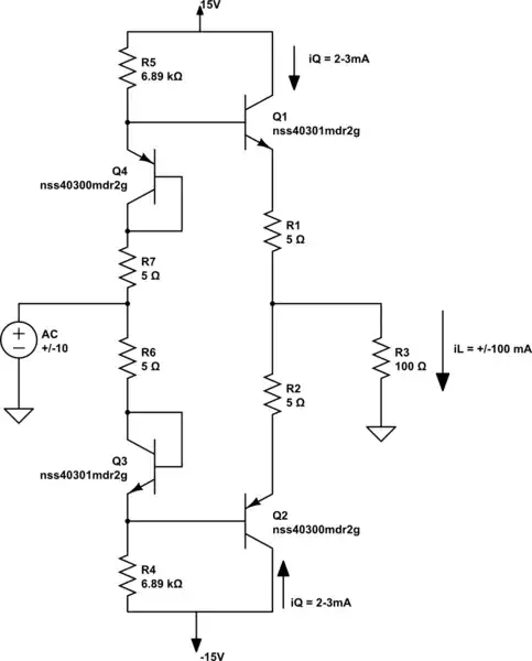

Background / Requirements:
I'm designing a typical Class AB amplifier using diode-connected BJTs to achieve the biasing. I have a requirement to keep the total quiescent current at room temperature to less than 8mA (from a single rail). Additionally the amplifier has to reliably source 100 mA \$AC_{pk}\$ to a \$100 \Omega\$ load over the industrial temperature range of \$-40^\circ C\$ to \$+85^\circ C \$. Here is the current rendition of my schematic:
My Problem:
The resistors R4 and R5 have to be sized such that they can supply the maximum base current required by Q1 and Q2. However, I cannot have R4 and R5 too low due to my low quiescent current requirement.

That is, both Is and NF can vary by 15% according to the datasheet. Now we get the the Monte Carlo analysis. In order to show that my circuit above works over device variation and temperature, I am performing Monte Carlo analysis in LTSPICE by varying all the BJT device parameters by 15% and Beta by 75%. This gives me huge base currents for some cases (much more than anticipated by the \$\beta = 179\$ calculation).
Am I being too hard on myself? By varying the device parameters by 15% over temperature, some cases give me a Beta <20. Which for most BJTs would be expected, but I specifically chose the On Semi NSS40302PDR2G for the seemingly excellent Beta.
Hopefully answerable Questions:
  1. Is my 15% device parameter variation using monte carlo analysis too harsh? Is the \$\beta=179\$ calculation at all likely?
  2. If answer to (1) is "No, you will actually see \$\beta < 20\$ after building many circuits", then any ideas on how to modify this circuit to make it more beta independent without adding many (if any) components?

  • So... you're varying \$\beta\$ by \$\pm 75\$%? Meaning at cold it's nominally 179, but goes down to 45 (before even varying \$I_S\$ or \$N_F\$)? It just seems strange that variation in \$I_S\$ or \$N_F\$ would do much to base current... Also, what type of randomization are you performing? Gaussian (gauss(x)), or flat distribution (flat(x))? Remember that *engineering limits* specify the absolute edge of the allowable parameters, not their \$\sigma\$. – Zulu Apr 16 '15 at 04:21
    Sorry if I wasn't clear! The SPICE models use \$\beta\$ of 500 or so. I'm varying \$\beta\$ by \$\pm 75\$ % and all other BJT parameters by \$\pm 15\$% according to a uniform distribution (using the mc(param,tol) command in LTSpice). So the \$\pm 75\$% represents the absolute limits of that parameter and the parameter is varied randomly within those limits. – VIANDERN Apr 16 '15 at 04:46
    In 5,000 runs at -40°C, the lowest \$\beta\$ I get is 72. Makes sense, because \$291\cdot0.25=72.75\$. And the sensitivity to \$I_S\$ or \$N_F\$ is very low. In any case, what inspires the \$\pm 75\$% \$\beta\$ variation that you're simulating? – Zulu Apr 16 '15 at 05:05
  • I just chose 75% because \$500\cdot .25 =125\$ which was in the range of my 179 calculation. Just curious, where did the 291 come from? – VIANDERN Apr 16 '15 at 05:17
  • Hm, that's an interesting question. I've left BF=445.496, and simulating to find \$\beta\$ for a diode-connected transistor gives a \$\beta\$ of 404 (27°C), or 291 (-40°C). – Zulu Apr 16 '15 at 05:21
  • That makes sense if BF is not altered. But the SPICE model BF is the best-case scenario for a typical case (the "Ideal maximum forward Beta"). – VIANDERN Apr 16 '15 at 05:29
  • What collector current got you to the \$\beta\$ of 291? – VIANDERN Apr 16 '15 at 05:38
  • I ran it at \$I_E=100\rm{mA}\$. – Zulu Apr 16 '15 at 17:07
  • R1,R2,R6,R7. they are all 5 ohm on your circuit which means that thier volt drop is very low compared to Vbe which spreads with unit to unit variation and of course temp.If you increase these resistors keeping thier values equal you will be much better off.If you can afford the loss of voltage swing then try 50 ohm. – Autistic Sep 14 '15 at 22:34
I don't now if your simulation is correct, but you could make it less beta-dependant by increasing negative local feedback, by for example emitter degradation, such as increasing R1 and R2.
By using a Darlington or Sziklai pair, R4 and R5 can be increased while still maintaining output current. Discussion of thermal properties: https://sound-au.com/articles/cmpd-vs-darl.htm#s4
If some crossover distortion is acceptable, the biasing voltage could be lowered so that the quiescent current through Q1, Q2 is 0.
