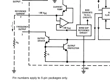

Sound like you want to drive an opto-isolator with an LM231 output.
The LM231 has an open-collector output and cannot source current- so it won't work with your circuit as shown. It doesn't have a quite enough current capability to be guaranteed to drive the 7mA you've chosen for the opto.

First off, to get 10mA through the opto-coupler LED you need to reduce the value of RLed. The LED drops about 1.2V, so RLed should be 380 Ohms or less.
Secondly, at 160k Rb may not provide enough Base current to get a reliable 10mA at the Collector. Using a much lower value would ensure that the transistor turns on fully, and also reduce Miller effect.
You could connect the LM231's output directly to the Base of the transistor, then it will turn off much faster because the comparator is providing a low resistance path to discharge the miller capacitance. With a 10k pullup resistor you should get rise and fall times of less than 200ns at the LED.
The 4N25 has inherently slow response, so your 100kHz square wave input will come out looking (at best) more like a triangle wave. This may be OK if you just want to get some kind of pulse through and aren't worried about distortion.
