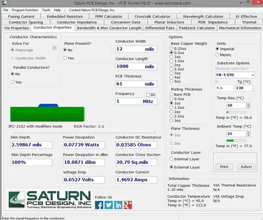

PCB Toolkit
With IPC-2152 modifiers enabled
The general window looks like this

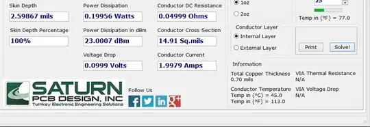

I've played around with the conductor width until I was able to ~2A. My input settings are the following
I believe my fab house starts with 0.5oz base and then plates up.
Here are the results for external layer
Internal layer (I've updated my conductor width to 22 mils)
If I were to change the option from plane present to no plane present, I get a different set of values.
Keeping the settings for the external layer the same, and changing only plane present: no

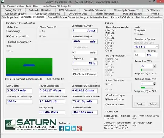

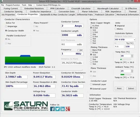

With IPC-2152 without modifiers enabled

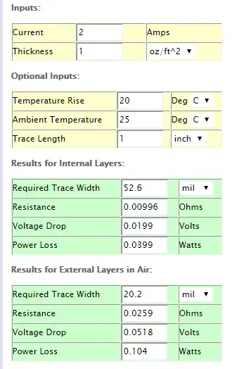

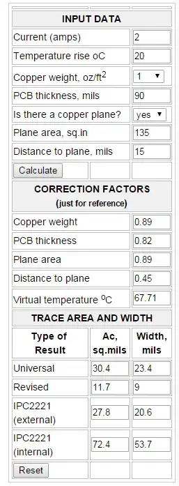

CircuitCalculator.com : PCB Trace Width Calculatr
I would have expected that the values to have been similar between the two, but they really are not.
If I were to enter the same values I had entered for the PCB Toolkit (with the exception of the plane present status and base copper and plating copper. I get the following

Circuit Calculator                            Internal Trace       52.6 mils
PCB Toolkit with IPC-2152 modifiers           External Trace       12 mils
PCB Toolkit with IPC-2152 without modifiers   External Trace       36 mils
Circuit Calculator                            External Trace       20.2 mils

    You seem to have calculated with an AC current at 1MHz in PCB Toolkit, while the CircuitCalculator tool probably assumes DC. I really think you ought to just design conservatively rather than squeezing out the last mil. How many 2A traces do you have on your circuit? Aren't you working too hard to save a dozen-odd mils of board dimension? – Atsby Apr 14 '15 at 07:00
  • @Atsby checking the DC option in PCB Toolkit does not change the current. It only affects the Skin depth. I have quite a bit of 2A traces, enough to be concerned with board space. – efox29 Apr 14 '15 at 07:03
  • Just out of interest, what is the IPC spec difference between "with and without" modifiers? The difference is massive! – Rev Apr 14 '15 at 10:56
  • @Rev1.0 can't say for sure. This is all I found http://www.saturnpcb.com/pcb_toolkit.htm – efox29 Apr 14 '15 at 13:52
  • @Rev1.0 I think it has to do with including board thickness and distance to plane. – efox29 Apr 15 '15 at 12:42

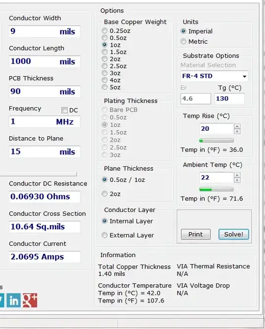

  • What about traces you cant touch directly ie, internal traces ? My high current traces are on internal layers and both layers are near solid planes. My current layer stack makes my outer traces 12mils and my internal ones 18 mils in order to achieve 50 ohm impedance. – efox29 Apr 22 '15 at 07:38
  • Internal layers can't dissipate heat easily so you need to take a larger safety margin. Alternatively you can simulate internal layer by covering your tracks with another PCB (make sure not to short any connection) and then quickly taking measurements after removing the cover. This will give you a crude understanding of the temperature rise in internal layers. – Whiskeyjack Apr 22 '15 at 07:58
    From what I have read into my investigation, there is greater thermal conductivity in the dielectric than air (assuming convection only). Given greater thermal conductivity and close proximity to a plane, I would think that heat would be spread out more vs concentrated near certain areas. This was one of the differences between IPC-2221 and IPC-2152. Thoughts ? – efox29 Apr 22 '15 at 08:08
