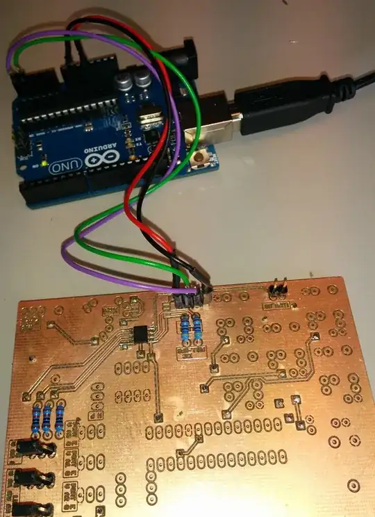

3rd image shows the setup (not the best I know, ignore the resistors by the jumpers originally fitted 1k's here and the inserted shorting links as per the 1st image)) enter image description here

    Do you currently have bypass caps installed on the board near the LM75? If not, give that a try. Also, the board was milled, right? How did you get continuity for your through-hole vias? Is it possible you have an intermittent connection somewhere due to poor continuity from top to bottom? – user57037 Apr 13 '15 at 19:20
  • It looks like you did not solder the pullups on the top side. They may not be making good contact with the top-side traces. If you are relying on the resistor lead to make continuity from top to bottom, you will have to solder the lead to the pad on both sides. – user57037 Apr 13 '15 at 19:27
    Hi mkeith, I used 0.8mm wire to solder through all the via's and soldered both sides. I have continuity tested all the ones directly related to the incoming I2C and LM75, but was planning to re-tin all these again tomorrow to be sure. The pulls only need to be soldered on the top side closest to the MCU connector pins, the other side is only a bottom trace connection. – Ant Apr 13 '15 at 19:30
  • Yes, I can see that the topside pads with no traces on them don't need solder. But it looked in the photo like there was no solder on the MCU side. I might be mistaken. Anyway, you said you will double-check, so that is all good. – user57037 Apr 13 '15 at 19:58
