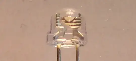

  • @RussellMcMahon What I am actually trying to do is not to focus an omnidirectional LED, but quite the opposite: to modify a led which is already focused (either by the conical metallic part inside, and also by the round lens shape of the casing itself) so that it sends light AROUND, and not almost exclusively to "the top", so to say. I added an image. – heltonbiker Apr 12 '15 at 02:53
  • (1) You can get TIR lenses that convert almost anything to anything. (2) Believe it or not (try it and you will) you can get substantially LESS directionality by simply cutting part of the top off. Probably all of the domed part and some more. Go down too far and you risk interfering with the LED proper - but you should be able to tell how much you can probably safely remove by examination. This approximates a "top hat" or "straw hat" LED. You can round the edges but this will probably not be necessary. More later maybe – Russell McMahon Apr 12 '15 at 05:18

Wide angle through hole LEDs are often referred to as Top Hat or Straw Hat LEDs due to their shape. The die is close to the external face and the package is often blunt ended to obtain the required radiation tpattern.
You can get substantially LESS directionality from a typical existing epoxy encapsulated through hole mount LED by simply cutting part of the top off so that the end is "squarish" and closer to the die. In this case, cut off probably all of the domed part and some more. Go down too far and you risk interfering with the LED proper - but you should be able to tell how much you can probably safely remove by examination. This approximates a "top hat" or "straw hat" LED. You can round the edges but this will probably not be necessary. Practice on a cheap LED first :-).
Commercial "straw hat" wide-angle LED.

  • Thanks very much for your help! Since the leds I'm getting from my local store are limited to round top (at least for amber/yellow color), and are quite cheap, I'll try adding the "M&M sized aluminum foil" mentioned in the other answer, since it seems easy enough and makes a lot of sense. I have already sawed off the top of one of the leds and the results were mixed: it diffuses a lot more, but still looking through the amber plastic (which is too close to the led, when everything is mounted), I can still see a small light dot. So the two-step reflection is something to be tried. – heltonbiker Apr 12 '15 at 14:19
