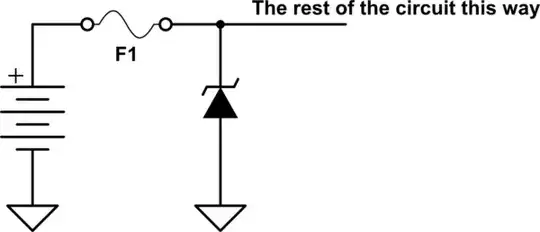

I've come up with this idea:
I think that if I reverse the polarity, the diode will short the supply and blow the fuse. Will it work this way?
The only weird thing is that I didn't find anything simillar when looking around the internet... so I'm assuming there is a catch.

  • The problem is finding a fuse large enough for your project but small enough to blow with dangerous currents. – Ignacio Vazquez-Abrams Apr 11 '15 at 21:52
    Have you looked into a PMOS as a pass transistor ? – efox29 Apr 11 '15 at 21:55
    @cube This is a well known and useful circuit, which does overvoltage, overcurrent, reverse polarity protection. The only catch is that the fuse takes a finite amount of time to blow, although in many cases that can be accounted for. This circuit had been discussed [here](http://electronics.stackexchange.com/a/39602/7036) and [here](http://electronics.stackexchange.com/a/85099/7036). – Nick Alexeev Apr 11 '15 at 21:55
  • why waste a fuse? why not put a diode in series with the supply (within the unit). If it is reversed then current won't flow. As a crowbar cct for overvoltage... common arrangement –  Apr 11 '15 at 21:58
  • what kind of batteries are we talking about? is it even worth protecting, given the generally really low chance of people getting to insert batteries the wrong way? You could also have a look at [Microsoft battery holders](http://patentimages.storage.googleapis.com/US20080268296A1/US20080268296A1-20081030-D00007.png) if its AA or similar – PlasmaHH Apr 11 '15 at 22:11
  • @Olin mentions a zener diode because you have used a zener diode symbol. You MAY have intended to use a zener diode here but based on your text you probably just meant an "ordinary" diode but used a zener symbol. – Russell McMahon Apr 11 '15 at 23:59
  • @PlasmaHH "is it even worth ..."-> Oh yes!!! :-). In situations where batteries can be backwards batteries will sometimes be backwards. Ask me how I know :-) – Russell McMahon Apr 12 '15 at 00:01
    This is for a small line follower robot and I'm still deciding if I need a reverse polarity protection at all. It will be powered by a 2S LiPoly battery and I could probably rely just on the connectors for not reversing it. – cube Apr 12 '15 at 10:15
    @RussellMcMahon: The question was for this specific situation. For a moderately cheap product it may be sufficient to blame the user if they did it wrong. – PlasmaHH Apr 12 '15 at 11:33

What you show is fine. However, the diode needs to be able to handle the large current from the time the power supply is connected backwards until the fuse blows. That could be several 100 ms. Check the fuse datasheet. Usually you would use a beefy diode, not a zener. There are such things as power zeners, but if you're only trying to protect against reverse polarity and not overvoltage, you don't need the zener function. Just get a power diode.
Note that in the overvoltage case, the zener will dissipate much more power until the fuse blows than in the reverse voltage case when it's acting like a ordinary diode. The zener will dissipate a lot more than the fuse, so finding one that won't melt before the fuse does will be tricky, and expensive when you do.
The fuse and reverse diode is occasionally used, but nowadays the trend is to not force the user to replace a blown fuse unless something has really broken, in which case replacing the fuse isn't going to do any good anyway. This is a cheap and effective way to protect against reverse voltage that hardly gets in the way when the voltage is applied properly. However, you have to consider whether users are going to get upset when the fuse blows.
Unless this is low voltage and every last bit of efficiency matters, you're probably better off putting the diode in series and simply blocking reverse voltage. At low voltage, use a Shottky diode to reduce the voltage drop when operating normally. Roughly at 100 V or more, use a ordinary silicon diode.

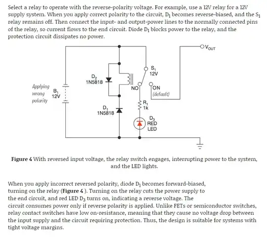

Another clever solution I found, with a relay and no voltage drop. Reverse protection with a relay

    The relay seems to be drawn incorrectly, or mislabeled. "NO" is Normally Open, and "ON" should be "NC". Also, it usually takes at least 10 ms for a relay to operate. which is long enough to damage circuit components. It may be better to reverse the operation so that the relay operates on correct polarity, although it will draw current. – PStechPaul Nov 28 '22 at 20:12
