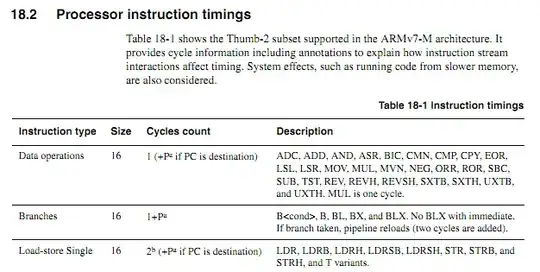

Timing information is available, but, as you pointed out, can occasionally be vague. There's a lot of timing information in Section 18.2 and Table 18.1 of the Technical Reference Manual for the Cortex-M3, for example, (pdf here), and an excerpt here:
excerpt of 18.2
which give a list of conditions for maximum timing. The timing for many instructions is dependent on external factors, some of which do leave ambiguities. I've highlighted each of the ambiguities I found in the following excerpt from that section:
[1] Branches take one cycle for instruction and then pipeline reload for target instruction. Non-taken branches are 1 cycle total. Taken branches with an immediate are normally 1 cycle of pipeline reload (2 cycles total). Taken branches with register operand are normally 2 cycles of pipeline reload (3 cycles total). Pipeline reload is longer [How much longer?] when branching to unaligned 32-bit instructions in addition to accesses to slower memory. A branch hint is emitted to the code bus that permits a slower system [How much slower?] to pre-load. This can [Is this optional?] reduce [By how much?] the branch target penalty for slower memory, but never less than shown here.
[2] Generally, load-store instructions take two cycles for the first access and one cycle for each additional access. Stores with immediate offsets take one cycle.
[3] UMULL/SMULL/UMLAL/SMLAL use early termination depending on the size of source values [What sizes?]. These are interruptible (abandoned/restarted), with worst case latency of one cycle. MLAL versions take four to seven cycles and MULL versions take three to five cycles. For MLAL, the signed version is one cycle longer than the unsigned.
[4] IT instructions can be folded. [When? See comments.]
[5] DIV timings depend on dividend and divisor. [Same problem as MUL] DIV is interruptible (abandoned/restarted), with worst case latency of one cycle. When dividend and divisor are similar [How similar?] in size, divide terminates quickly. Minimum time is for cases of divisor larger than dividend and divisor of zero. A divisor of zero returns zero (not a fault), although a debug trap is available to catch this case. [What are the ranges, which were given for MUL?]
[6] Sleep is one cycle for the instruction plus as many sleep cycles as appropriate. WFE only uses one cycle when event has passed. WFI is normally more than one cycle unless an interrupt happens to pend exactly when entering WFI.
[7] ISB takes one cycle (acts as branch). DMB and DSB take one cycle unless data is pending in the write buffer or LSU. If an interrupt comes in during a barrier, it is abandoned/restarted.
