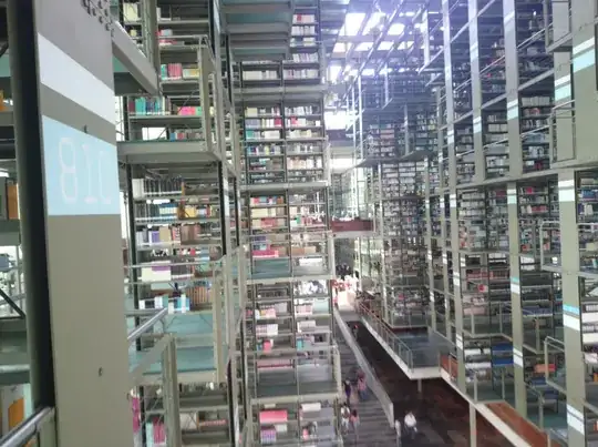

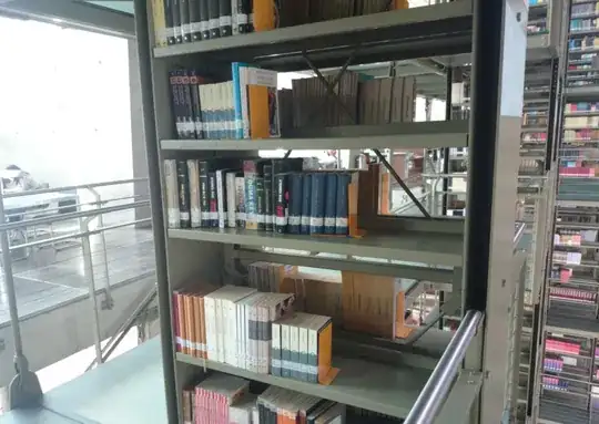

I just came from the local library, it’s quite big, and most of it is made of an architectural design using mostly painted metal book shelves painted with some kind of anticorrosive paint along with glass floor all over the place, everything was fine and nice, until I started to get static electricity shocks around every single book shelf (yes the painted ones) in every floor almost all the time I took around 13 shocks in less than 20 min
As you can see most of the metal structure it’s joined by huge bolts (screws) so there is continuity all over the place (I checked) also there is a possibility to the metal structure to be joined to the structural studs of the building

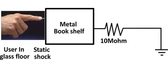

I’m trying to find out how is it possible to "fix" something of this magnitude As an antecedent I installed an antistatic mat in my own home lab, along with the nonexistent at the time grounding rod and wiring across all the home, I do know antistatic mats have a huge impedance that “slows” the flow of current to mains earth while it discharges the body slowly to protect electronics of voltage differences between the desk, user and electronics, being at the same potential, like in the following picture

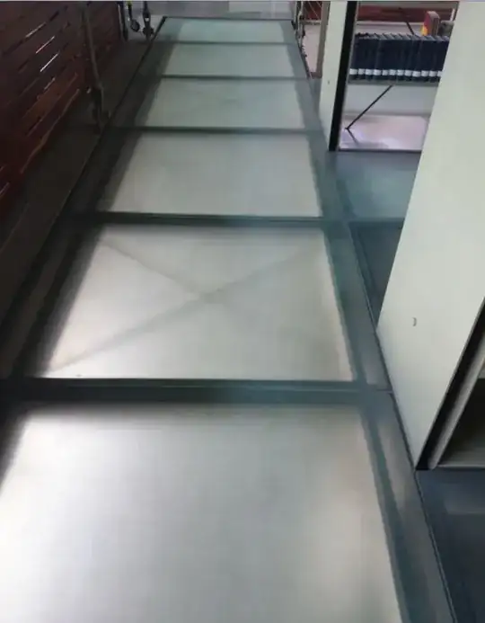

My theory for the library is that the users being insulated of earth and by being walking around a glass floor, are generating static electricity just by walking with their clothes on, the electrons find no way to discharge around the glass and as soon as they touch any metal book shelve they get discharged, there’s a chance of the system being grounded to mains earth, but as I recall a door knob can shock you like this even by not being grounded so I’m not sure, and a bit confused now
I’m thinking on several ways to solve this
1) The first idea that came to my mind was to to an arragement like an antistatic mat, add a 10MOhms power resistor to join the book shelves in several points to mains earth, this “might” slow the current flow of electrons and no shocks will be sensed, however my common sense tells me that the mat itsle fhas a high impedance unlike the book shelve, this might work to slow the flow across the resistor but it would make nothing for the user that will still get shocked due to the low resistance of the metal book shelves and THEN it will be slowed down across the resistor

    I think the root cause of the static discharge problem is the glass floors, because glass is near the positive extreme end of the `triboelectric series`, and typical shoes have rubber soles -- a material near the opposite end of the triboelectric series. – MarkU Apr 11 '15 at 01:32
