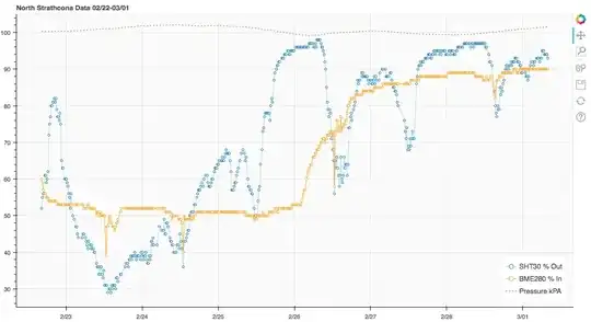

This is an old thread but as an example of what can happen, I just made a test, February 2023, for the last 6 days using a clear plastic food enclosure with a plastic cellophane and a screw lid on top.
I had 2 sensors: SHT30 outside the enclosure. BME280 inside the enclosure.
There was a PG7 cable gland at the bottom for the SHT30 sensor. This was made in Vancouver Canada during a sunny and snowy winter weather. Data on the plot below, the pressure is in kilopascal to fit on the axis. Relative humidity
kimchi weather station
