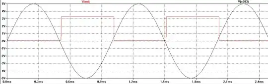

I need to transform a bipolar sine wave (varies from -5 V to 5 V, 1 kHz) to a square wave for further digital processing (0 to 3.3 V), as in this image:
Sine wave to 3.3 V square wave
The important thing is that this sine wave can't be distorted, so there can't be any limiting diodes at the input.

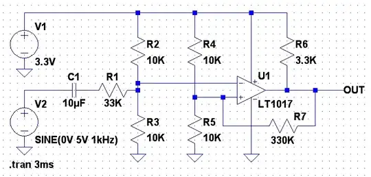

I would like to suggest that the comparator circuit shown by @hwengmgr could use some small improvements over what was posted.
Improvements include:
  1. Bigger capacitor value to reduce filter effect of the capacitor at frequency.
  2. Larger value resistors in dividers to reduce current load on source supply.
  3. Added hysteresis at the comparator to make the circuit less sensitive to noise that may be on the input waveform.
  4. Changed pullup resistor on output of comparator to a more sane value for 1mA load instead of 33mA.
This was simulated with LT-Spice. I used a model for a comparator that was built into the package library. You can substitute a comparator of choice as long as it is specified for operation at a Vdd of 3.3V.
The addition of the hysteresis feature necessitated the swapping of the '+' and '-' inputs of the comparator which causes an inversion of the output waveform. If this is a problem it can be easily flipped with a logic element. If you select a dual comparator the other half of the package could be used to invert the signal.
Michael Karas
  • 56,889
  • 70
  • 138
  • That's amazing. Thank you. That answers all of my answers :) Well... almost. What kind of capicator should I use as this coupling 10uF one? Some kind of film capicator? – przeski Apr 05 '15 at 14:20

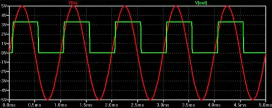

If its a continuous waveform, you can use a DC blocking capacitor and then use some resistors to set the DC common mode point and scale it as well. Then feed it into an LM339 comparator to get your digital output. Something like this. I have NOT calculated the resistor ratio's! But setting R3 will let you attenuate the incoming waveform. R4/R5 sets the threshold for switching the comparator output. R6 is needed because the LM339 is open collector output.
hwengmgr
  • 590
    I simulated this using PSpice and using 1uF and 1K for R3, I get a sine wave of 0 to 3V into the comparator, from an input of a sine wave going from -5V to +5V. – hwengmgr Apr 05 '15 at 12:15
  • This is looking quite simple and I like it. Is there any reason I shouldn't be using higher values of resistors? For example 10k instead of 1k? – przeski Apr 05 '15 at 13:06
  • you can use larger resistors. just remember that the capacitor will look like a resistor of value 1 / 2 * pi * 1khz * C (assuming 1KHz waveform) so you need to add it into the calculation for the attenuation. – hwengmgr Apr 05 '15 at 13:26

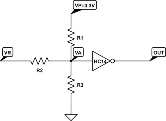

Take this schematic :
Playing with Ohm's law, you get : \$R_{3} \times R_{1}\times V_{R}+R_{3} \times R_{2} \times V_{P} = (R_{1} \times R_{2}+R_{1} \times R_{3}+R_{2} \times R_{3}) \times V_{A}\$
If you set VR=0, VA shall be equal to VP/2=1.65V. You get :
\$R_{1} = \dfrac{R_{2} \times R_{3}}{R_{3}+R_{2}} \$ (or R1 = R2 parallel with R3)
For the maximum input voltage, 5V, VA=VP :
\$R_{3} = \dfrac{R_{2} \times V_{P}}{V_{Rmax} - V_{P}} = \dfrac{R_{2} \times 3.3}{5-3.3}\$
So.
With standard resistor values, you can pick : R1=10k, R2=16k, R3=30k
The gate should have a Schmidt trigger, and support any intermediate voltage at its input, for example an HC14. If you are afraid of exceeding the +5V/-5V range, you can add clamping diodes at the input of the inverter.

    +1 for the good old superposition theorem in practice, with my favouritte R-based DC coupler. –  Apr 05 '15 at 15:36
  • Note that you wrote that the sine wave should not be distorted, AC coupling could be better, as here the current drawn is different on the positive and negative halp periods. – TEMLIB Apr 05 '15 at 16:52

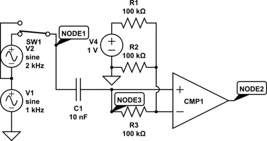

One thing you don't mention is whether the square wave needs to be square even if the sine wave may be distorted. I don't think a Schmidt trigger is needed here since the sine wave's dV/dt will be at its maximum near the switching point. A simple way to achieve a reasonable result would be:
Once the circuit "warms up", it should give a 50%-duty-cycle square wave when given a sine-wave input. If given a distorted wave, however (in "build" mode, click "SW1" and click "properties" to switch its state) the output may not be quite square. There are other ways of setting up the circuit to ensure a 50%-duty-cycle output even in the presence of even harmonic distortion on the input, but this approach is nice and simple. The voltage divider for the comparator's reference voltage may be set to any convenient value; the duty cycle of the input is controlled by the symmetry of the input, rather than resistance ratios; designs to yield a symmetrical output when given a distorted input would have a duty cycle set by a resistance ratio.
supercat
  • 45,939
  • 84
  • 143
  • C1 10pF is a ridiculously small capacitor whose impedance is nearly 16 megohms at the 1kHz operating frequency. The unspecified comparator will be unable to deliver much more than noise (or not even noise if its input leakage current through R3 is enough to keep the output low). – cuddlyable3 Apr 05 '15 at 23:53
  • @cuddlyable3: It's 10nf; sorry NODE3 was placed to obscure that. The intention of the circuit was to suggest that the same voltage divider can be used for the DC bias as for the reference. Using separate dividers will cause any difference between them to contribute additional unwanted offset. – supercat Apr 06 '15 at 03:30
