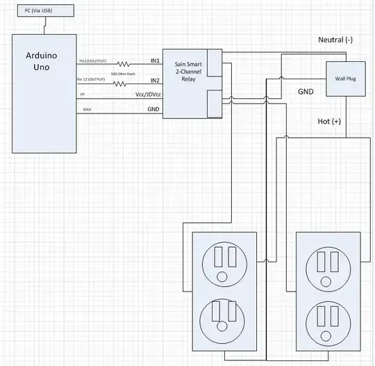

Edit 3: Circuit Diagram. Yes, its ugly. The switches on the Sain Smart are closed when IN1/IN2 are pulled low. And now I see there is a built in schematic function here. Good to know for next time. Circuit Diagram for Problem

A circuit diagram will help a great deal. Something sounds fishy with your connections. It sounds like you have some feedback to your arduino (which you shouldn't have) when a load increases. You could maybe add an opto-coupler between your relay and your arduino, but that would be treating the symptoms and not the cause. My 2$
AJBotha
  • 416
  • Thanks, I'll pop the box open and draw a circuit diagram later today when I get home from work. I haven't done anything fancy- each wire in the 3-wire cord branches into two wires. Ground to ground on the GFCI's- Hot to hot on the GFCI's- Neutral to relay. Then relay to hot on the GFCI's. I have the relays configured to be normally connected; the outlets are on unless I pull pins low. The Arduino has two digital pins connected to IN1 and IN2 on the relay (pins 11, 12, iirc). 5V Arduino output and ground, to + and GND rails on breadboard. – FourMileIsland Apr 01 '15 at 14:21
