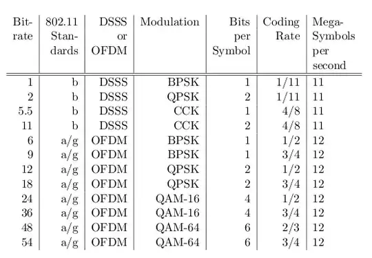

802.11g uses OFDM, a pretty complex modulation scheme which employs multiple overlapping orthogonal subcarriers (meaning that at each subcarrier peak, the sidebands of all other subcarriers add up to zero). 802.11g uses 52 subcarriers, 48 of which carry data. These subcarriers are spread over 16.25 MHz (not 22!), and can be modulated using one of several constellations, of which QAM-64 is the largest. Convolution codes are used for forward error correction.
To operate at 54 Mbps, 802.11g uses the QAM-64 constellation and 3/4 convolution code rate. 48 Mbps is exactly the same but with a more redundant convolution code, 2/3. The QAM-64 constellation enables each subcarrier to carry 6 bits of information per symbol. Each symbol lasts 4µs in 802.11g.
All of the above are well reasoned but ultimately arbitrary numbers, but multiplying them together gives you: 6 bits * 48 subcarriers * 3/4 error correction coding = 216 bits per 4µs. That's 54 million bits per second.
