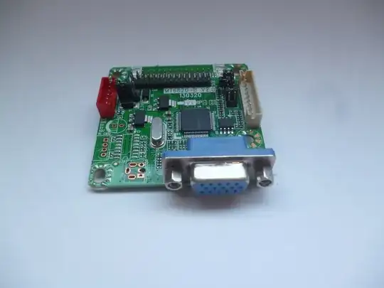

you can use a Universal LVDS LCD Monitor Driver Controller Board like this enter image description here
Rafalenfs
  • 64
  • This answer has some potential but is lacking information. A photo is nice but a precise reference to what the board is would be much more interesting. Image search basically returns a short comment on http://www.instructables.com/id/Old-laptop-screen-into-Monitor/ without actual information on product. So, does there really exist a universal controller board and where to get more information? – Stéphane Gourichon Dec 08 '16 at 05:09
