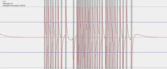

So far I have been testing with my desktop PC. I wrote a Java app that can detect pulses (interrupts?) from the audio-in (mic) port. I am able to hook up a single flow meter by connecting the +5v from the audio-in port to the +5v of the flow meter and the ground from the audio-in port to the pulse line of the flow meter. I don't know if this is the proper way, but it works in that I get a signal from the flow meter and I can see the pulses like so:
flow meter pulse reader app

extra: from your screenshot, it is clear you have a capacitor on your microphone input (likely inside the phone). As you can see, this has an effect that an 'average' voltage one the input will be 0 volt. You can see it on the graph -- if you give, say +5V volts, then in few tens of ms, the capacitor will charge to +5V and the input will see 0 volts(+5 - +5). If you now give 0V on input, the card will see -5 volts (0 - +5V). But soon, capacitor will discharge and you will see 0V again.
