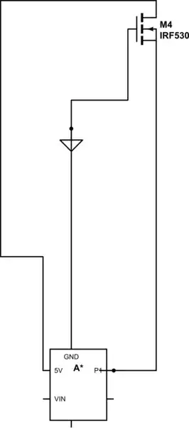

Attempt at drawing out configuration in first video, where the A* microcontroller is getting 5V of power from its usb plug:
Attempt at drawing schematic of video 2
simulate this circuit
Attempted schematic for a new 3rd video, trying to power the relay separately.

  • Show us *exactly* how you connected that module to your microcontroller and to the 5V power. The relay module needs three wires, to ground, 5V, and microcontroller output pin. – Wouter van Ooijen Mar 24 '15 at 18:33
  • @WoutervanOoijen The 2 videos in the post show the wiring. Im sorry I don't have a better way to explain this. I don't know how to use the diagram tool. – tmsimont Mar 24 '15 at 19:01
  • The video is not clear enough to be sure what you are doing. It is not that difficult to start with the wiring tool. If all else fails draw your circuit on paper and post a photo. On the video I see you are using a 9V battery: be aware that that is a very poor power supply. Better use any 9-12V DC wall-wart you can find. Statistically there must be >10 per household :) – Wouter van Ooijen Mar 24 '15 at 20:28
  • ok i tried to add some schematics. I'm not sure if I'm using the right symbol for that relay module... – tmsimont Mar 24 '15 at 21:12
