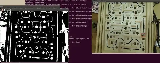

...and here's a screenshot of my software:
screenshot

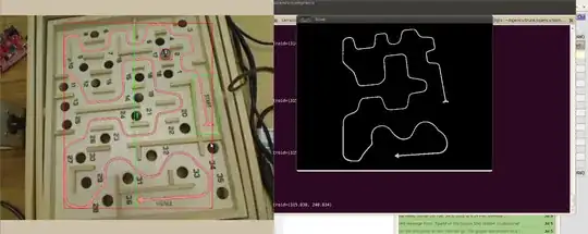

Blob trajectory isolated
I have isolated the trajectory but I am not able to find the correct function to print the correct pixel coordinates from the starting point. Any thoughts?
