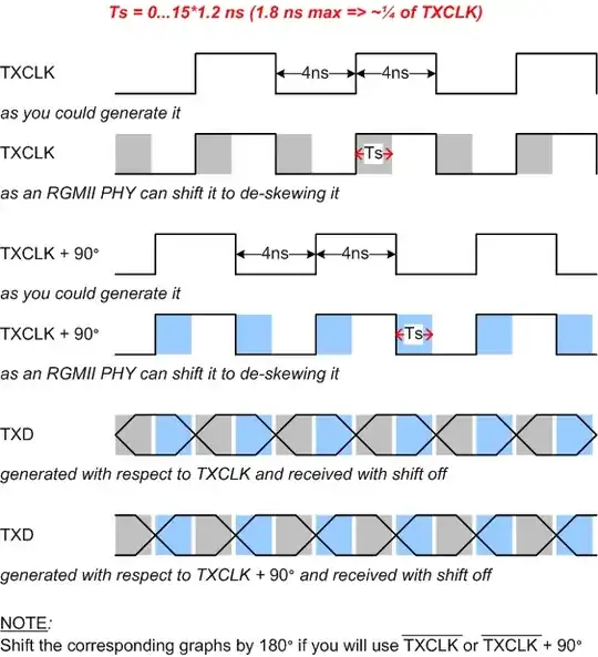

Maybe it's not a direct answer to your question, but i want to draw your attention on the following possible workarounds:
  • skew rate is controllable both at RGMII PHY and FPGA IC
    Typically RGMII PHY implements a de-skewing mechanism (e.g. KSZ9021 can absorb skews up to 1.8 ns, very near to that what you need), therefore (if your phy has it, of cause) you activate it. Shift (delay) the clock at your PHY keeping the data the same. Shaded areas on the picture below explains this graphically.
    Also, additionally to the PHY shifts if not enough, you can correspondingly configure slew rate at FPGA slowing the data while fasting the clock.
  • pcb tracing could be yet flexible, not dogmatic
    (if, of cause) You can (then) route the clock trace "proportionally" longer than the data (or vise versa, depending on direct/inverted clocking).

Your way (not only calculations) about ODELAY looks correct, but i (and i think anybody) cannot confirm/refute it because that correctness can be approved finally only in the design (board) where various side effects, like clock jitter, which are difficult to predict and simulate, can be observed and estimated.

First, you need to distinguish what do yo want: "pure" RGMII (referred to as Original GMII in the document you mentioned) or "clock-shifted" RGMII (RGMII-ID in the document). Your rgmii.vhdl code is about the "shifted" one. Here, i recommend you to re-choose yourself to "pure" RGMII because (from the RGMII document dated 2002 and from PHY/SERDES ICs i used) any modern GbE PHY supports clock/data shifting and your has no need to sophisticate your code.
Second, for any value you'll selected for ODELAY, you'll need to approve and a hundred to one to tune it on the live board by an oscilloscope in your hands. 26 is normal, let it be your initial tap for step-by-step iterating.
