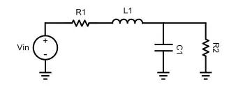

Then you map that to a circuit, like one of these: http://en.wikipedia.org/wiki/Butterworth_filter#Filter_design
Capacitor reactance is \$1 \over Cs\$ and inductors are \$Ls\$, so the transfer function is
\$H(s) = {Vout(s) \over Vin(s)} = {{1 \over {C1 s}} \| R2 \over {L1 s + R1 + {1 \over {C1 s}} \| R2}} = \frac{R2}{C L1 R2 s^2 + (C R1 R2 + L1) s + (R2 + R1)}\$
So
  • Numerator:
    • R2 = 9.8696e+008 Ω = 987 MΩ
  • Denominator:
    • C*L1*R2 = 1
    • C*R1*R2 + L1 = 4.4429e+004
    • R2 + R1 = 987 MΩ
So then R1 = 0 and L1 = 44.4 kH?? and C = 22.8 fF?? ...Oh man, I don't remember this stuff.

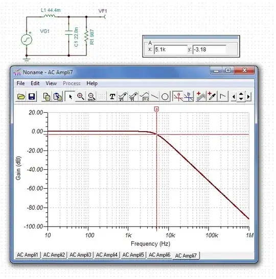

So you could then scale all the values simultaneously to more reasonable ones. Multiply the capacitor by some value, and divide the inductor and resistor by the same value to keep the filter the same. For instance, multiplying by 1 million gets us into a more reasonable range:
  • C = 22.8 fF * 1000000 = 22.8 nF
  • R2 = 987 MΩ / 1000000 = 987 Ω
  • L1 = 44.4 kH / 1000000 = 44.4 mH
Hey, it works!
TINA simulation of reasonable values
