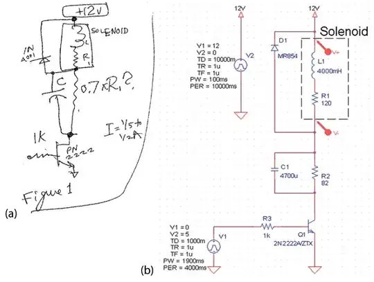

One more note: solenoids are typically not modeled as purely-inductive devices. They have inductance, but at steady-state they're resistors. A quick Google search yielded fewer results than I expected, but I did find this: some random circuit diagram
He used a BJT, but I've personally always liked MOSFETs for this sort of thing.
