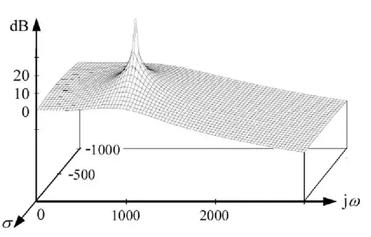

Bode plot is not a graph that plots the transfer function (\$H(s)\$) against \$s\$. \$H(s)\$ is a complex function and its magnitude plot actually represents a surface in Cartesian coordinate system. And this surface will have peaks going to infinity at each poles as shown in figure:

The graph shows the difference between the natural frequency in the complex \$s\$-plane (infinite) and the corresponding magnitude peak along the \$j\omega\$ axis which can be observed during measurements: The graph belongs to a natural frequency of \$\omega_p=1000\$ rad/s and a pole quality factor \$Q_p=1.3\$ (which is a measure of the observable gain peaking). This plot visualizes a 2nd-order Chebyshev characteristics with 3 dB ripple in the passband.
