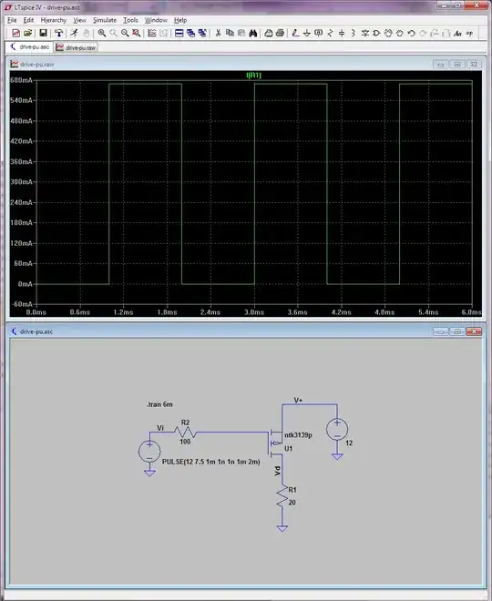

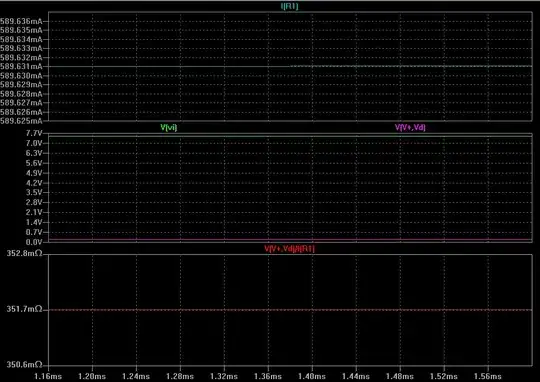

If I simply save that PSpice file to a ntk3139p.lib file and import it in LTspice, it all works fine:
The Rds(on) looks in line with the datasheet for that part.

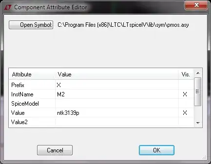

What you need to keep in mind is to change the PMOS statement line to X (because it's a subcircuit) and match the name to the subckt name declared in that lib. Ctrl-click to access the advanced properties page for the FET:
This is actually explained in detail at http://www.linear.com/solutions/1083
