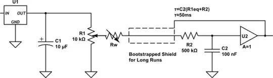

In many precision, low-noise designs, it's a bad idea to start with to even have the signal routed through the front panel. So, at the very least, the control element should merely produce a voltage signal that governs a voltage-controlled amplifier/attenuator. With a potentiometric source, you can buffer and low-pass-filter the control signal, so that wiper dropout effects are minimized.
Here, a voltage reference feeds the potentiometer. The variable wiper resistance is modeled by Rw, which can vary by 9 orders of magnitude, but is mostly "low" and on the order of an Ohm. R2 keeps the time constant above 50ms. Since R2>>R1, R1's influence is small. C2 forms a low pass filter with R1+R2, but also acts as a hold capacitor. U2 is an op-amp set up in non-inverting mode, so that its input has a very high impedance. The output of U2 goes to a voltage-controlled amplifier.
C2 should be a low-leakage type with NP0 or plastic dielectric, and U2 should have a FET or CMOS input stage. So, don't use 741 for U2 with expectation that it would work all that great - although it will still work better than the naked potentiometer would.
If the wire from R1 to the circuit is long, you might need a bootstrapped shield. Some experimentation is necessary to ensure stability of the circuit then, though, as the shield-to-signal capacitance adds positive feedback to the system.
That already gives you a much better performing circuit than using a potentiometer directly on the signal. Even with a fairily short 50ms time constant, you can get rid of crackle even on the most ridiculously dirty potentiometers. You can always trade off response time for insensitivity to crackle.
