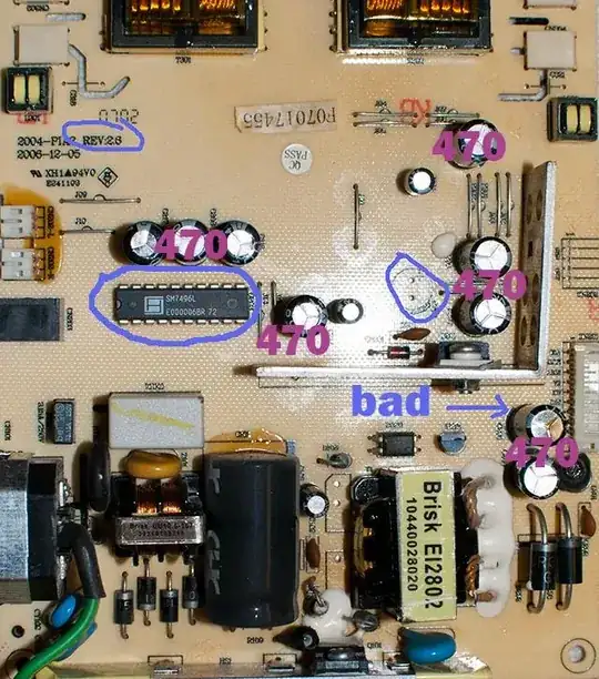

I have a bad capacitor on this LCD power board. I have rev 2.6, and I noticed there is a rev 2.8 board that looks like it didn't get skimped on in parts. Can I install capacitors in my rev 2.6 board as they are used in the 2.8?
My board:
x20wg-1080p rev 2.6
9 x 470μF, 1 x 100μF, 1 x 22μF, 1 x 10μF
Here's the rev 2.8:
x20wg-1080p rev 2.8
6 x 1000μF, 4 x 470μF, 1 x 100μF, 1 x 22μF 1 x 10μF
The differences are circled in blue. My board seems to use lower rated capacitors, is missing one, and the microchip looks slightly different. The pictures are of the entire boards.

    When attempting to write an answer for you I realized there is a lot of data that you haven't told us here. I have answered with a lot of assumptions, but you will need to tell use more about what the capacitors are connected to before we can really tell you what to do. – Kellenjb Jun 23 '11 at 17:35
  • Those 470u/1000u BFC's are usually filter caps and it is usually okay to use a bigger capacitance there, probably preferred as bigger capacitance ususally means less ripple and noise. I bet my bottom dollar the the circuitry on Rev. 2.6 and 2.8 here are largely the same so it should be harmless to use 1000uF caps there. However you should get the low ESR types rated at 105 degrees Celsius as it is the high ESR that killed the caps via heating. And since you are at it, you can also try replace all those BFCs using quality brand parts. – Maxthon Chan Jan 04 '15 at 07:00
The IC that you are pointing out is a 3W (or maybe a 2x 2W) stereo audio power amp.
The one in rev 2.6 is a SM7496L, which I am having a hard time finding any info about, but it is essentially the same thing as rev 2.8 just a different manufacture, so it is probably safe to assume that circuit should be the same around them. This means it should be safe to put a larger capacitance value on it.
For the group of 3 with one missing, it looks like these are next to something that is probably a voltage regulator with a big heat-sink on it. If this is the case, go read the answers for this question Capacitor Sizes for 7805 Regulator
For the other 2 capacitors, these look like they could either be used with the 2 diodes or could also be for the voltage regulator.
