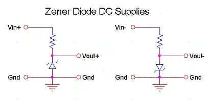

  • If you're willing to tolerate more parts and a larger size, you can use a source-follower circuit. Take the left-hand circuit in steven's answer, then connect an N-channel enhancement-mode FET's gate to Vout+, its drain to Vin+, and then its source becomes your new Vout+. This can handle a lot more current than a zener by itself and also works across a wide range of load currents. The trick will be picking the resistor to provide enough current to the zener at minimum Vin+, and not burn too much power at maximum Vin+. There's negligible current through the gate. – Mike DeSimone May 30 '18 at 05:55

A regulator would be the best solution, but a zener (one 'n') is ok, at least if you don't want to draw too much power from the regulated voltage. You don't place the zener directly on the -12V, but use a series resistor to limit the current. It's this series resistor which dictates how much current you can draw. The -12V will still be available.
To calculate the resistor value, you have to know how much current your load will draw. Suppose this is 1 mA. Also suppose the zener diode needs 10 mA. That's 11 mA through the resistor. Voltage drop is 12V - 5V = 7V. Then R = 7V / 11 mA = 640\$\Omega\$.

Safest you handle the situation by setting the Zener parallel with the load. You calculate the resistor and Zener combination so that when your load takes zero Amps, your zener is able to handle the current without burning.
Example your load takes from 0mA to 100mA current. Supply Voltage is 12V. Needed Voltage is 6V.
You need a Zener Pd=5W to handle the current when load takes no current.
Resistor value is (needed Voltage drop)/(max load current) so in this case 6V/0,1A = 60 ohm. Check the power dissipation of the resistor (PdR). PdR = Iload * Iload * R = 0,1A * 0,1A * 60 ohm = 0.6W.
So 6V 5W Zener and 60 ohm 1W resistor are needed exact values without the the fear of overheating.
You can use a resistor value of 56 ohm(easier to find from shop). The Zener can handle the extra current.
