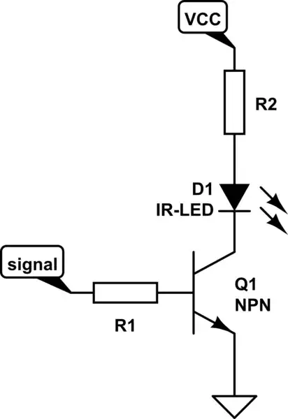

  1. Series drive
  2. Shunt
  3. Shunt with over and under-drive
1. Series
  • Q1 directly switches the LED
Pro: Low average power supply current
Con: Low speed (< 30-50 Mb/s)

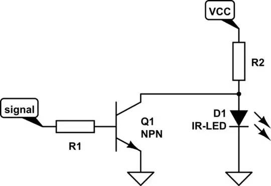

2. Shunt
simulate this circuit
  • Q1 shunts the LED - so a quick discharge == fast turn-off time
Pro: Higher speed (several times faster then 1)
Con: Higher power dissipation (circuit draws more current when LED than when LED is on!)

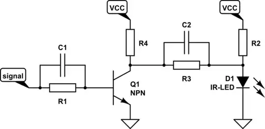

3. Shunt with Over & Under Drive
extends 2.
  • C1 decreases the switching times of Q1
  • R3, R4 and C2 provide over-drive at turn-on and under-drive at turn-off
  • typical RC time constant for R3 + C2 == rise/fall time of LED
Pro: higher resulting speeds than 2.
Con: carefully chosen values needed - otherwise destructive

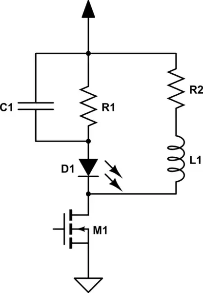

I wanted to add this circuit which I saw in a paper. It has both over drive and under drive but I don't know how it compares to 3. Shunt with Over & Under Drive in Stefan Kruger's answer though. Seems like it should be lower power...at least when off. Again, values have to be carefully so the positive current peaking on the charge and the negative current peaking on the discharge (and their associated voltage spike applied to the diode) don't fry it, though you might be able to place a TVS in parallel to protect the LED and make component selection critical without sacrificing speed.
I have yet to use this circuit but you might be able to improve turn-on speed with a large bias resistor in parallel with the MOSFET so that the LED is biased when off. However, the MOSFET leakage current might be sufficient for this or it might be unnecessary with the current peaking. I suppose you could also change it to be an emitter or source follower to prevent saturation if the transistor speed ends up somehow being the limiting factor.
