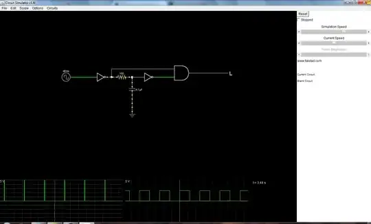

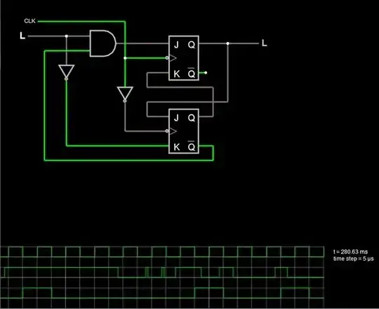

Input: oscilating pulses (Function Generator) + button;
Output: single pulse from oscilator;
Simulation on Falstad's
circuit diagram and result

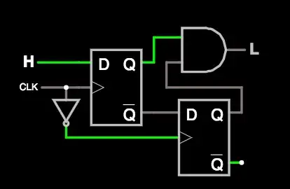

one easy way to do this is with two d-flops and some logic gates. this will produce a pulse exactly one half a clock long, which is to say the output pulse is equal to one high pulse of the clock. it will never output a partial pulse. very similar but a bit simpler than Raivis's answer. see a simulation here.enter image description here
