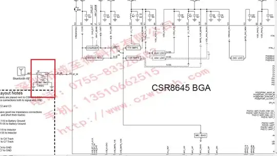

It's all down to prevention and protection. First, protection. Most widely spread boards like Arduino have ESD protection (they would have very small success otherwise seeing how people can easily generate discharges), and generally very few reports are made of boards rendered non-functional by ESD. However discrete components such as transistors exclude those, therefore if you build a circuit around those you and you alone have to make sure the circuits are protected of such discharges.
Generally those are based on diodes that clamp the input voltage/drain the energy away from the input:
