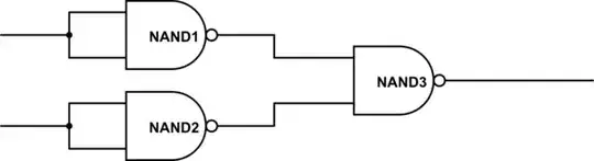

And that's the same sequence for Q as the NAND gate. So an OR gate is just a NAND gate with the inputs inverted. And we know how to invert already. So the OR looks like:
simulate this circuit
So now you know what the gates look like you can put the whole thing together:
However there's too many gates there. It can be simplified. The bit I have marked with a box - a NOT followed by a NOT - that's completely pointless (from a logic point of view) and is just wasteful. It serves no purpose. So you can get rid of it. Simplify to:
