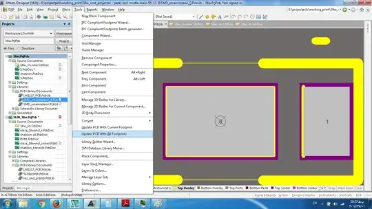

Two why to doing this:
1-go to your PCB component library and select : TOOLS >> Update PCB with ll Footprints, which change all PCB that used this library in any project !!!
like this :
2- Save the new PCB component library with new name, In Schematic of those project go to:
TOOLS >> Footprint manager then select all component which you want to change it's footprint PCB library and in right part select edit option and change those component footprint then select Validate >> Accept Changes (Create ECO)
Like this:
enter image description here , Then from TOOLS >> Update From Library >> Next >> Finish, Then From Design >> Update PCB Document ...
