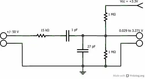

I try to connect an ESP8266-12 and a 12V RGB LED strip to 230V AC. Based on this link, I've came to the following scheme. This will also be the first time I will etch a PCB myself. enter image description here

I'm still unsure about what transfo to use? I was thinking about the MYRRA 44090 TRANSFORMER 1.5VA 24V. I'd like to get some feedback on this pick.
Also I'd like to gain some feedback if this scheme is safe to use. I assume the ESP8266-12 will be isolated from the net since I'm using a transfo?

    Does your board need to connect directly to mains? The most common solution is to use a 12v wall wart that already has all the necessary safety testing and approvals. – Grant Feb 21 '15 at 16:25
    A note on your schematic: Dots where wires cross or meet indicate a connection - you seem to be using the dots to indicate "no connection" - this will hopelessly confuse the netlist and board layout software when you come to lay out the PC board. – Peter Bennett Feb 21 '15 at 17:09
You're using a 7812 to make 12V from the DC voltage from the bridge rectifier. You need approximately 2V more than 12V to make that work (officially 1.5 or 1.25 I think, but this is safe to use). That means you need 14V from the bridge rectifier.
When rectifying an AC voltage of \$x\$ volt, you get a DC voltage of \$x\cdot\sqrt2\$ volt. That means you will need an AC voltage of \$14/\sqrt2\approx10V\$. With a 24V AC transformeter, you will get a very high DC voltage, about 34V, much higher than necessary. All the other Volts, 34-14=20, will need to be disippated as heat by the regulator. This is not only a waste of energy, but also may cause issues when the regulator gets overheated. A heatsink is a solution, but a transformator that gives you, say, 12V AC would be better.
