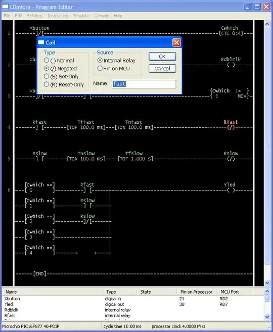

You will probably need to provide MODBUS or PROFIBUS protocol interface, and make drivers to interface 0..20mA, 4..20mA, 0..10V, TC, motors, encoders (or use MODBUS/PROFIBUS slave cards with built in such drivers)...
If you want to program your device in ladder logic instead of C/ASM/PAS/BAS, you can. This software provides that.
Ladder Logic Compiler
