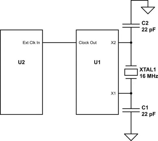

What I have done when I needed to share a clock between micros is to have the crystal drive the oscillator on one micro and then use the oscillator output pin (typically CLKOUT or OSCOUT) from that micro to drive the second micro.
I would expect problems trying to drive two oscillators from the same crystal, if for no other reason than that the capacitance of the long PCB traces required to go between the two processors would cause a malfunction.

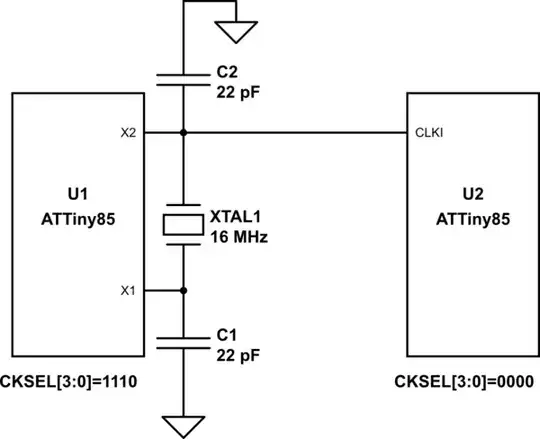

That is not quite what you want. When you use a crystal to form an oscillator, you are using an inverter internal the the microcontroller to drive the crystal. If you connect both micros to the same crystal, they will fight and not work.
Therefore you will want to pick one of the two micros to serve as the crystal driver (configure as shown in section 6.2.6 of the datasheet) and the other micro to use an external clock input (6.2.1 of data sheet). Then change your schematic connection like this:
Alternatively, if symmetry is desired you can use an external oscillator as opposed to a crystal. Then both could operate in external clock mode.

  • There is a definite need to adjust the upper capacitor in this set-up, if one wants the full benefits of the predictability of a crystal. – Asmyldof Aug 27 '15 at 22:27
  • @Asmyldof I definitely need the timing precision of the crystal. Maybe the symmetrical solution is needed? How is an external oscillator connected? – GisMofx Aug 27 '15 at 22:32
  • Good point @Asmyldof – Houston Fortney Aug 27 '15 at 22:41
    so if C2=10pF (assuming about 10pF loading due to the CLKI input) and keep C1=22pF, right? – MarkU Aug 27 '15 at 23:16
  • Plus keep the trace between the micros nice and short. Buffer if needed. – Houston Fortney Aug 27 '15 at 23:18
  • This answer should be merged with the post this question duplicates, because it is good. If it gets dupe closed. – Passerby Aug 28 '15 at 00:21
    @Passerby That's why I want to keep **this** question alive. The other question didn't provide any clear schematics. – GisMofx Aug 28 '15 at 13:02
  • @HoustonFortney Since the ATTiny with the crystal has `SUT=11` (max startup delay), that the second ATTiny will also need that same delay. Could this cause any issues? – GisMofx Aug 28 '15 at 13:06
    No it will just come up as is if it was using any external clock. – Houston Fortney Aug 28 '15 at 13:08
    @GisMofx I flagged it asking for the answer to be merged, so that it gets moved over to the other question, so it can be preserved. – Passerby Aug 28 '15 at 13:29
