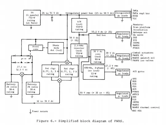

EDIT: And, yes, the AC was 50V RMS. Found a diagram in a later NASA conference:
From that conference, Viking was even more complex having additional 400 Hz AC inverters. There's also mention in that coference of Galileo having the same redundant inverter configuration as Voyager (but no other details, presumably because it was just in the design stage then).
From a GE Voyager design document, it seems Voyager was initially designed similary to Viking, having some 400 Hz busses, but was revised to use only 2.4 KHz AC in the last iteration. The reason for the use of 400 Hz equipment is obvious, i.e. sharing parts with aviation equipment. I'm guessing the 2.4 KHz equipment was reasonably easilly derived from the former (as the frequency is a multiple), but I haven't found the rationale for 2.4KHz AC said explicitly anywhere yet.
Here are the details on Viking, confirming use of some 400 Hz power buses:
The VO had 2.4-kHz single-phase, 400-Hz three-phase, regulated dc (30 V and 56 V) and unregulated dc (25 V to 50 V) power sources. Unregulated dc power was also provided for the VLC. Arrays of photovoltaic cells arranged on four double-section, folding solar panels furnished primary power for all Sunoriented operations. Two identical nickel-cadmium batteries were used as a secondary source of power for off-Sun operations and to share the load when power demand exceeded the solar array capability. Redundant power conditioning and distribution functions were provided with two battery chargers, two booster regulators, two 2.4-kHz inverters, two 400-Hz three-phase inverters, two 30-V dc converters, and associated power source logic and control and switching functions. (See the simplified block diagram in fig. 6.) The hardware, operating modes, and performance are described in detail in the section "Power Subsystem." The VO unregulated (raw) power bus was supplied by solar panels and batteries. These two power sources formed a dynamic system characterized by three stable in-flight operating modes, and a fourth short-term operating mode as follows: [it goes on for a couple of pages, so I've snipped the modes]
