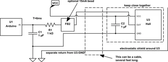

Let's say that we want to keep the mosfet switching times roughly at 2% of the PWM period. The mosfet should switch in approximately 2.5us. The low-pass filter formed by the gate drive resistance and the gate capacitance should have a time constant of, say, half that value. Thus, assuming a 1nF gate capacitance, we need an equivalent 200 Ohm series resistor in the gate drive circuit.
Ensure that the fast-switching current loop, drawn in thick line, is kept as short as possible. The decoupling C1 needs to be a low-ESR electrolytic. The snubber C2/R3 can be designed following this procedure. The buffer U2 can be 74HC1G125 or similar. It needs to have its power supply decoupled with a 47nF capacitor, and have its output enabled (OE# input driven low). U2 needs to be close to M1. To ensure fastest turn-off, the D2/D3 is a pair of back-to-back 27V Zeners. F1 should be sized to accommodate the power consumption of L1. The GND of U2 needs to be tied to the star point at M1's drain. Ideally you'd also have ferrite beads between U2's VCC and the 3.3V supply rail, as well as between the star point at top of L1 and the output of the fuse. The FB1 is a ferrite bead - choose the largest impedance you can find that will handle 100mA.
To minimize the Hall sensor's capacitive coupling to the inductor, there should be a non-magnetic, conductive shield around it. It won't hurt to make an explicit low-pass filter on the sensor's output, as well as decouple any high-frequency content with a ferrite bead FB2. Choose the largest impedance you can find that will handle 15mA.

  • Thank you for another great answer! What is the purpose of U2? I have never worked with buffers before, and I do not have one at hand. Is it essential? – Torben Feb 12 '15 at 19:44
  • The buffer output can provide more current than Arduino's max output current. The buffer does not change the logic signal (IN=OUT). – Triak Feb 12 '15 at 19:51
  • @Torben The buffer's purpose is to redirect the gate charging current away from the Arduino. Remember that in your use case, Arduino is an analog, noise-sensitive part. – Kuba hasn't forgotten Monica Feb 12 '15 at 20:00
  • @Triak The maximum current through R4, given 5V logic, is 25mA, so Arduino could provide it, but you don't want it to, since it will couple into the analog signals. – Kuba hasn't forgotten Monica Feb 12 '15 at 20:07
  • Okey, that makes sense. I will order one of them then. What does FB1 and FB2 represent in the new diagram? – Torben Feb 12 '15 at 22:09
  • @Torben They are ferrite beads. Pretty much get the largest impedance you can find that's rated for the needed current. FB1 would need to withstand 100mA. FB2 would only see 10mA. – Kuba hasn't forgotten Monica Feb 12 '15 at 22:29
  • Okey :) Is this an okay buffer? http://www.chonelectronics.com/product/74hc125-hd74hc125p-74125-quad-bus-buffer-tri-state-ic/ – Torben Feb 12 '15 at 22:32
  • @Torben Yes, that buffer will work. Make sure that you ground **all** unused inputs. – Kuba hasn't forgotten Monica Feb 12 '15 at 22:44
