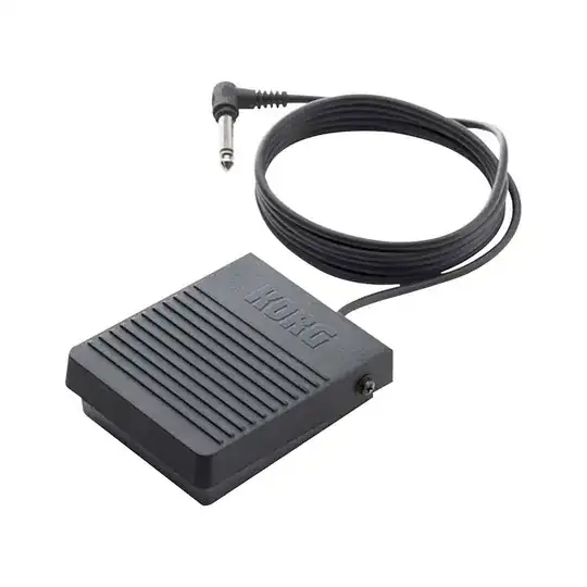

I have a sustain pedal (which is just a momentary switch!) with the wrong polarity (according to the device I'm using it with) :
  • circuit is CLOSED when pedal is pressed
  • circuit is OPEN when pedal is released
I would like the opposite.
Is there an electronical solution to invert the behaviour of such a switch, with only passive components (without having to use a battery-powered component, etc.) ?
