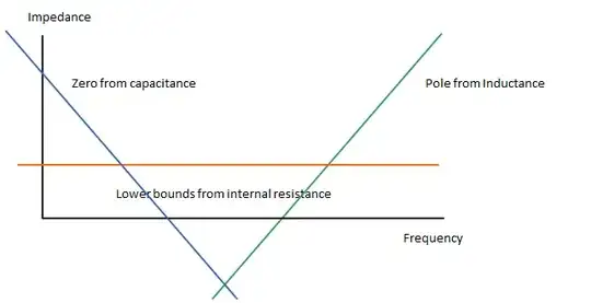

As stated in both the forum post and the app note the physical geometry of a capacitor dictates the self-inductance. In the case of decoupling the capacitor can be modeled as a small power supply with internal resistance, inductance and capacitance. In the frequency domain the view of the internal impedance of the capacitor is a "trough" where the beginning (zero) of the trough is dictated by the capacitance value and the end (pole) is from the parasitic-inductance. The lowest point of the trough is set by either the parasitic resistance or the lowest value of the resonance frequency of the LC combination of the capacitor / parasitic inductance value (whichever produces a higher impedance).
The following is an image illustrating the characteristics of a capacitor
here is the equation for the resonance frequency. $$ \frac{1}{2\pi \sqrt{L \times C}} $$ -Thanks for catching that Olin
By this reasoning one can choose the largest size capacitor in the given package size, for example 0402, and the properties of the pole will not change and only the zero will be moved to a lower frequency (in the image, the downward slope would be moved to the left for large capacitor values) allowing a wider bandwidths of frequency to be bypassed. The resonant pole that defines the upper portion of the capacitor should encompass any higher value capacitor of the same package size.

Since the package size is the part of the cap that mitigates the pole or the upper bound of the impedance of the modeled power supply, then it shouldn't matter if I were to use a 0.001uF cap 0402 package, or a 0.47uF capacitor 0402 package. A better method to determine the Fris of the cap is to find the frequency at which either the internal resistance or the effective capacitance intersects with the pole (whichever point is higher). Is this correct? or is there some other factor that I have not taken into consideration?

  • Size *is* important. The 1nF cap may not hold enough energy to bridge the dip. You'll have to know what kind of current causes the dip and its duration. – stevenvh Jun 13 '11 at 16:20

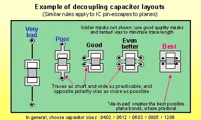

The ideal would be to use lots of 0.1 uF caps in an 0402 package. Place them under the chip on the back side of the PCB. The cap be routed as in the image below. And the vias go directly to the power/ground planes (not to the chip's power pins, as that would usually increase the inductance). If you place the cap under the chip then sometimes you could share the same via without any issues.
proper decoupling cap layout
The reason why a 0.1 uF cap was chosen is because it is the highest practical in an 0402 package. The reason why 0402 was chosen is because it is the smallest practical size, and you want to use a lot of them to get the effective ESL/ESR down. Of course all bets are off if you have a 2 layer PCB without power and ground planes.
