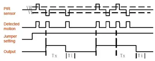

  • Perhaps you should try to adjust Tx and Ti as specified in the datasheet? Tx = trigger pulse width, Ti = inhibition period. – HKOB Feb 10 '15 at 20:59

  • @HKOB, that was my thinking in shorting across R13 and R33 on the ITEAD's PCB. It helped, but didn't shorten the time as much as I had hoped. I tried shorting across the capacitors that also affect the timing, but found it made the sensor non-functional, so it seems like there are minimum limits to the timing, and I'm over my head trying to figure it out. I'd also much prefer finding PIRs that are designed to sense often, rather than modifying them. Thanks for the suggestions. – user2418372 Feb 16 '15 at 20:21
  • There are no R13 and R33, however in the datasheet schematic there is R9, R10, C6, and C7. If you rather reduce the value of C6 and C7, say to 1 nF, that has a little bit higher chance of working. (if you just short over the resistor, there may still be something limiting the current internally in the IC) – HKOB Feb 16 '15 at 20:27
  • Oops, I posted the same link twice. The second link (fixed now) is to the PIR's PCB, which I was referencing when I mentioned R13 and R33. Anyway, thanks for the suggestion re: capacitors. – user2418372 Feb 16 '15 at 21:23
  • Ok, after looking at the new schematic I suppose my suggestions stands: removing CY1 and CY2 and shorting R13 and R33, should give maximum effect for the control circuit. Although it might not work so well anymore, as some minimum value for these components might be necessary. – HKOB Feb 17 '15 at 13:10

In the posted schematic, R13, along with RT1 (The Time potentiometer) and CY1 control the On Time of the Module's output. R33 and CY2 control the Minimum Off Time. There is also Jumper JP1 which handles the Trigger mode.
The Formula for the On Time is Tx ~= 24576 * Rx in kΩ * Cx in µF. This provides time in milliseconds. Multiply by 0.001 for seconds. R13 + RT1 = Rx. RT1 can be anywhere between 0Ω and 1MΩ (1000kΩ). CY1 = Cx. In the Schematic, CY1 is a 103 capacitor, which is 0.01 µF. Given this, we can calculate the two time ranges, when you shorted R13 out (Value of 0):
Tx = 24576 * (0kΩ + 0kΩ) * 0.01 µF * 0.001 ~= 0 seconds
Tx = 24576 * (0kΩ + 1000kΩ) * 0.01 µF * 0.001 ~= 245 seconds
The Off Time is similar. Ti = 24 * Ri * Ci, again times 0.001 for seconds. Ri = R33, Ci = CY2 (104 means 0.1µF). Since you shorted R33 out...
Ti = 24 * 0kΩ * 0.1µF * 0.001 ~= 0 seconds
Multiplying by 0 is easy. That said, we don't know how the BISS0001 handles the time, if it has a minimum period or not. Other PIR sensor ICs use a RC circuit to create an oscillator, so shorting the resistor would break the oscillator function.
Also consider JP1, which connects pin 1, A (Mode Select). If tied to Low/ground, it will not retrigger if motion is detected while the output is already high/on. If tied to High/Vcc, it will retrigger, meaning the On Time clock restarts, even if the sensor is already outputting high. So if someone is moving around in the field of view, it won't turn off in the middle of movement.
Also, don't forget to turn the Sensitivity potentiometer to it's highest setting.
But assuming you have On Time set to 1 second or less, and Off Time set to 0 seconds, and sensitivity potentiometer set to MAX, you still have to deal with the PIR sensor. The BISS0001 handles detection logic, but the sensor itself is an analog device that has it's own conditions for signaling a change. Short of it is, depending on the fresnel lens you have on it, which helps widen and divide the field of view, which direction you have the sensor pointed at (people walking directly towards the front of it will be less noticeable compared to people walking across it's field of vision.), and how quickly the sensor detects the changes based on it's composition, it does take time for the module to trigger. The PIR sensor AND the BISS0001 logic chip both [likely] have hysteresis to prevent over sensitivity and chronic triggering. The sensor requires time to reset when first turned on, and map the field of visions' default Infrared State. It only maps changes from one "picture" to the next.
