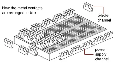

The most probable explanation is that something has deformed the individual spring finger contact so it doesn't make a good contact with the wire. Other reasons could include some sort of contamination (spilt liquid) coating the metal, oxidation through excessive local heating (too much current 'burning' the contact).
see http://www.bbc.co.uk/schools/gcsebitesize/design/electronics/industrial_designrev5.shtml
