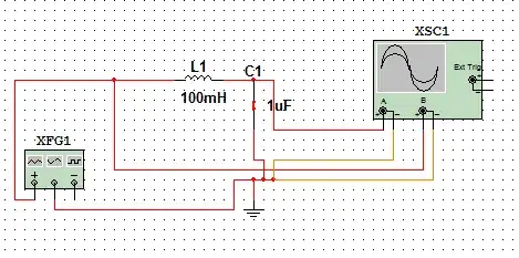

I am trying to simulate LC circuit using external source that generates square wave of 503Hz of amplitude 2V as below: enter image description here

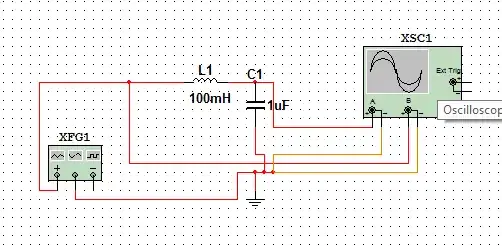

Natural frequency of circuit above is 503Hz.So it must pass this much frequency.When I run the simulation of above circuit,capacitor gets damaged or shorted (don't know exactly) and it appears in circuit like :
and output becomes zero in oscilloscope.

That's the problem with simulating with "ideal" components — you see behaviors that you would never see in the real world.
Your circuit has no resistance in it anywhere. The function generator is an ideal voltage source with zero output resistance. The oscilloscope has infinite input resistance (open circuit). And the components have no parasitic series or parallel resistance, either.
Therefore, the behavior that the simulator is showing you is correct. The 503 Hz sine wave is the L-C circuit continuing to "ring" from the start-up transient. This ringing will never die out. And you see none of the 5 kHz square wave at the output because your filter has infinite "Q" (quality factor), which means it blocks other frequencies perfectly.
When simulating a circuit that has only ideal components, you need to remember to model the parasitic effects of real components. Depending on the accuracy that you need, you might include the series resistance of both inductors and capacitors, and maybe some parallel capacitance on inductors and parallel resistance on capacitors as well. Usually, when simulating more complex circuits — which almost always contain resistors anyway — the effects of these parasitic components are insignificant.

  • First,thanks a lot.I understood that square wave of 5kHz can be represented as sum of sinusoids and it is only passing the 503Hz component and blocking the rest.But when I pass 503Hz sinusoid or square wave,why capacitor blast ? Filter must simply pass input as output.Isn't it ? It even blast when I connect resistor of 0.1 ohm in series with inductor to make circuit more realistic as you mentioned. – Abhinav Feb 08 '15 at 12:48
  • I'm sorry, but I don't know what you mean by "blast" in this context. I assume you mean that the capacitor is damaged in some way, but do you mean shorted or open? – Dave Tweed Feb 08 '15 at 13:10
  • For clarification,look at capacitor in second image of this question.Isn't it distorted from normal representation ? By "blast",I mean capacitor is damaged in some way.When this happens,output simply goes to zero. – Abhinav Feb 08 '15 at 13:18
    Are you saying that the simulator changed the drawing as a result of running the simulation? I don't know what that means, but if the output went to zero, it must mean that the capacitor is shorted. – Dave Tweed Feb 08 '15 at 13:27
  • Okay.Can you explain why capacitor is shorted when sinusoid or square wave of frequency around 503Hz is passed through this circuit ? – Abhinav Feb 08 '15 at 13:35
    Ah, I didn't understand that you were talking about two different simulation scenarios. Again, ideal components. When driving the circuit at its resonant frequency, the energy supplied by the function generator builds up in the L-C circuit because there's no resistance to dissipate it. Eventually, the voltage (and current) levels get so large that numerical overflow occurs in the simulator software, and they must be indicating that by "shorting" the capacitor. – Dave Tweed Feb 08 '15 at 13:46
