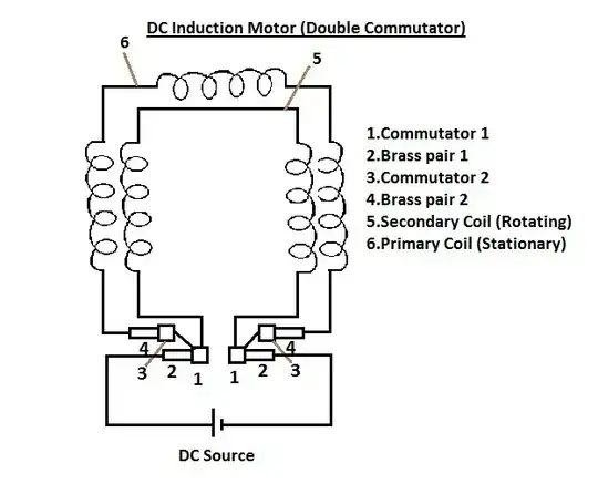

Yes,It's Possible,but not so efficient.You need two commutators to build such a motor.The first commutator receive current from source supply it to the rotating coil and second commutator.And the second commutator supply current to the stationary coil.The impression of this kind of motor is given in this image.
