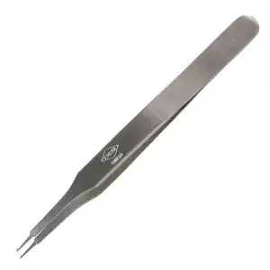

tweezers
The wrong tweezers can be very frustrating. Rounded tips are definitely out. Good tweezers should open and close(*), and not allow any movement whatsoever in the perpendicular direction. I use Erem 102ACA tweezers, and they never let me down.
The tip shape makes working with 0402s doable. The tips are also very thin, so that they allow you to place components very close together.

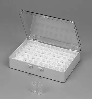

component storage
You can store your SMD MLCC capacitors (unmarked!) in compartmented boxes, but the Law of Conservation of Misery says that you'll accidentally drop that part you just picked in one of the other compartments. Unmarked MLCC, great!
These Licefa boxes are a solution.
They contain 60 phials (there's also a box with 130) sized 1cm x 1cm x 2cm high. If you need a part you can take out the phial, so that different parts don't get mixed up. A phial can contain dozens of passives. I find them useful for packages up to SOT-23.
One minor point is that they're not antistatic.
