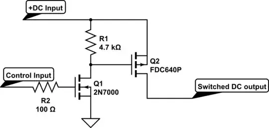

You need something called a "High-Side Driver" circuit. This allows you to control a higher voltage power supply from a low-voltage control input.
This can be made from either bipolar transistors or MOSFETS or a combination of both. I'll show a simple version using a pair of MOSFETs - note that the high voltage being switched is limited by the maximum voltage that can be applied to the gate of the high-side FET. But it will do for illustration purposes and can be enhanced with the extra components needed for voltages higher than the max allowable Vgs of the upper FET.
R2 is included only a a precaution against Q1 oscillating, It should be mounted as close to the FET as possible.

  • Thanks but I'm unsure about what the individual purpose of Q1 and Q2 is (see also the diagram below where I was unsure as well). Why can't the effect be achived with a single MOSFET? – Morty Feb 07 '15 at 14:39
  • @Morty: because there's no way to provide the necessary voltage levels for a single-transistor/MOSFET solution by your MCU. – Laszlo Valko Feb 07 '15 at 16:31
  • What is the advantage of using a `n-MOSFET` for Q1, instead of a simple NPN transistor, like a 2N3904? – not2qubit Feb 25 '19 at 23:16
  • No real difference between using a BJT or MOSFET for Q1. I often use a BJT for Q2 as well but that requires an extra resistor or two. – Dwayne Reid Feb 26 '19 at 17:14

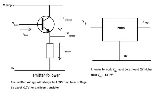

As Dwayne has given a very suitable working circuit (+1 from me) I will concentrate my answer on why your circuit does not work.
You have made three basic errors.
(1) You are using the BC547 (NPN transistor) as an emitter follower and not as a switch. This means that the voltage at the emitter will always be about 0.7V less than the base voltage. If you supply a 5V base signal the output cannot rise above about 4.3 volts no matter how much you reduce the base resistance value. Switching from the positive line use a PNP type transistor or preferably a P channel MOSFET (see Dwayne's answer)
(2) For a 7805 to work it must have a minimum of 2V difference between input and output. There are other regulators that require less (Low Drop Out or LDO). Even these could not work because they need the input to be higher than the output. There should be a minimal voltage drop across the switching device. MOSFETs are superior to BJTs.
(3) A 7805 (as distinct from a 78L05) is capable of a 1A output, if your circuit had managed to switch the regulator ON you would have fried the transistor if a current larger than a few hundred mA was drawn from the regulator. Ensure that any device you use to switch the regulator is capable of switching sufficient current.

  • Some things you say in point 2 are misleading at best. Yes, a 7805 needs considerable headroom on the input, up to 2.5 V. However, there is still plenty of room from the 7.5 V needed at the input to the 12 V power supply. *"There should be minimal voltage drop across the switch"* is wrong in this case. Even a darlington would be fine here, and may actually be a good answer. – Olin Lathrop Feb 07 '15 at 14:28
  • Thanks I will look up the emitter follower etc. Regarding error #2 it's really a consequence of error #1. If the NPN has been able to switch the 12V (with, say, some small voltage drop of 0.7V) it would have been plenty for the 7805. Regarding #3, actually all I need is around 20 ma on the output side, but it is still more than what I want to draw from the Atmega directly. – Morty Feb 07 '15 at 14:36
  • @OlinLathrop - point 2 is certainly not misleading given the information in the question. The point is that the circuit shown is an emitter follower that uses the transistor in its linear region. It is not a common emitter circuit used in its saturated region. The input signal is 5V. If the input signal was raised to about 8V or above you could get the circuit to work but it still doesn't work as a transistor switch. Personally I think it is good practice when using any electronic device as a switch to have the minimum voltage drop across it. This does not exclude any bjt or mosfet solution. – JIm Dearden Feb 07 '15 at 18:33
  • If is often useful to minimize the voltage drop across a switch, but insisting that it is always good practice is just religious silliness. In this case, there is at least 4.5 V that will be dropped somehow somwhere, if not in the switch then in the regulator. This is a great example where it makes sense to allow a higher voltage drop across the switch to get better values for other parameters that do matter. – Olin Lathrop Feb 07 '15 at 20:16
    @OlinLathrop Apparently it is such a good example that you totally fail to mention it in your answer. I also notice you have gone a 'minimal voltage across the switch' design. Do I accuse you of "religious silliness" - No. I'm certain that all experienced designers of switched mode power supplies, digital chips etc. have in their mind to minimise the voltage drop across a switch in order to improve efficiency (good practice). You are correct that in this particular case that energy will have to be lost somewhere. Changing to a 78L05 would help (point 3) by limiting a S/C output to about 100mA. – JIm Dearden Feb 10 '15 at 12:54
