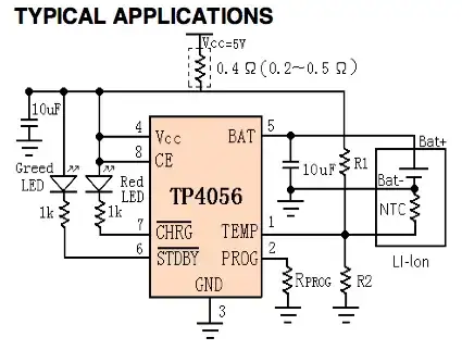

I'm using a solar panel (6V - 600mA at peak power) to charge a Li-Ion (3.7V) battery using a TP4065. The TP4065 I'm using has this configuration:
TP4065 circuit

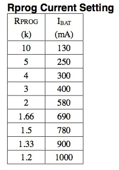

Where the value of the resistor Rprog determines the charging current.
Resistor to current table

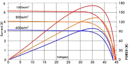

The issue is that the current the solar panel provides is proportional to the light it received and the only way to keep extracting the maximum power from the solar panel is to adjust the load to keep to solar panel voltage around 6V which in my case is controlled by reducing the charging current.
What would be the best circuit to automatically adjust the Rprog resistor to keep the TP4056 Vcc at a constant voltage of around 6V?
Here is an example of a solar panel IV curve showing the voltage where the maximum power is extracted.
Example of solar panel IV

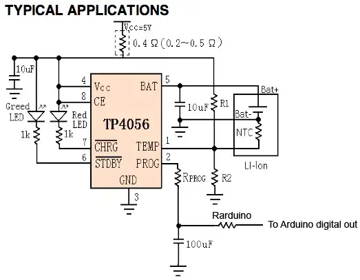

My project will use an Arduino micro controller. I could use the Arduino to monitor the solar panel voltage and regulate the TP4056 current with the following circuit:
Other Solution
Rprog and Rarduino would be 600 ohms and the 100uF capacitor and Rarduino will act as a low pass filter for the Arduino analog out that output a 3.3V 500Hz PWM signal.
When digital out is 0V, the TP4056 will see a 1.2K resistor and behave normally. As we increase the analog out voltage, the voltage at Rprog will decrease which will decrease the current in the TP4056 PROG pin and finally reduce the battery charging current.
Does this solution can work?

    Your question is in error. Modulating the charge current using RPROG will not help you charge your battery faster at all. Just set RPROG for the sunny day maximum (whatever that is). If you want to extract maximum power from the solar panel, you need to use at least one DC-DC converter, and in that case, it would probably not make sense to use a linear charger. – user57037 Feb 07 '15 at 21:31
    The battery, solar panel, and charger are all in series (except for the small quiescent current consumed by the charger). So maximizing solar panel power output is not the goal. You want to maximize current output. Hopefully you see my point now. – user57037 Feb 07 '15 at 21:35
  • Take a look at this: http://cds.linear.com/docs/en/datasheet/3652fd.pdf The idea is that you would adjust your Vin to the maximum power point (note that maximum power point voltage does not change much with light level). It may not work with your 5V solar panel, but if you could consider getting a higher voltage panel it could work. – user57037 Feb 07 '15 at 22:01
    @mkeith It will charge faster because when the solar panel can only deliver 100mA and the charger wants 1000mA, the solar panel voltage drop to a voltage that the TP4056 can't work properly and doesn't charge at all. – Pat Feb 07 '15 at 22:24
  • @mkeith it would make sense to maximize the current as a priority but as you can see in the charging graph image, the current is not constant to a high value to charge the battery. So the only solution left is to control the charging current to not overload the solar panel – Pat Feb 07 '15 at 22:27
  • So what do you want to do? limit the charge current so that VCC can stay above 5V? This will handicap you even worse. I would suggest for you to find another charger that will work better. There are some which automatically back off when the input rail starts to collapse. I know TI has some. I didn't look at the datasheet for this part. – user57037 Feb 07 '15 at 23:46
  • @mkeith I added a solution to my question, what do you think? – Pat Feb 12 '15 at 23:46
  • Yes, I think the basic idea will work. You have to take care not to push current into the node. No telling what will happen if you do that. I did something similar to control brightness on a backlight boost converter once. When PWM output is continuously low (0% duty cycle) the current will be maximum, and will be as if R = RPROG+RARDUINO. I would suggest to make RPROG fairly small, and make RARDUINO much larger. If you want to be totally safe, add an N-channel mosfet between RARDUINO and GND. Control the gate with your PWM signal. – user57037 Feb 13 '15 at 03:07

I like the answer you suggested a lot. I think it is a good idea. I would suggest just a slight variation as follows:
revised PWM control
Also, please work through the corner cases and unusual circumstances such as when the battery is dead, and arduino cannot power on. Will the charger be stuck in a zero charge current mode? Maybe a strategic pullup or pulldown somewhere, or a large resistor in parallel with RPROG and 100uF cap to insure small charge current even when PWM is off.

    I think I will power the Arduino directly on the solar panel so that I never run into a dead end problem. – Pat Feb 13 '15 at 04:36
  • Also the maximum current the PROG pin can give is 1.2mA. The arduino analog out can give or sink 20mA so I don't think the mosfet is required – Pat Feb 13 '15 at 04:38
  • I am not worried about the current. The problem is that the PWM output (assuming it is totem pole) is a higher voltage than the PROG pin voltage. If you go to 100% duty cycle accidentally, it will cause current to flow into the PROG pin. Not sure what effect this would have. It could damage the chip. On the other hand, if you can configure the PWM output to be "open drain" or "open collector" then it should be fine. – user57037 Feb 13 '15 at 05:04

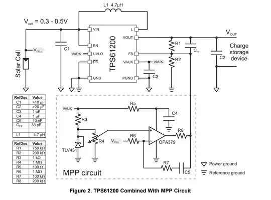

The TPS61200 IC from Texas, on its datasheet has a great circuit schematic for what you're looking for here. Instead of installing a MCU, one can simply add a secondary circuit with an opamp for maximum efficiency of the solar cell.
schematic - TPS61200 Combined With MPP Circuit
Image source: Texas Instruments - Supplying TPS61200 With a Single Solar Cell
